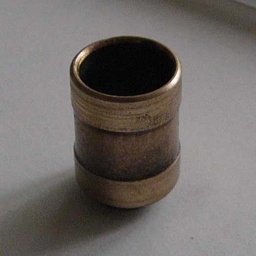

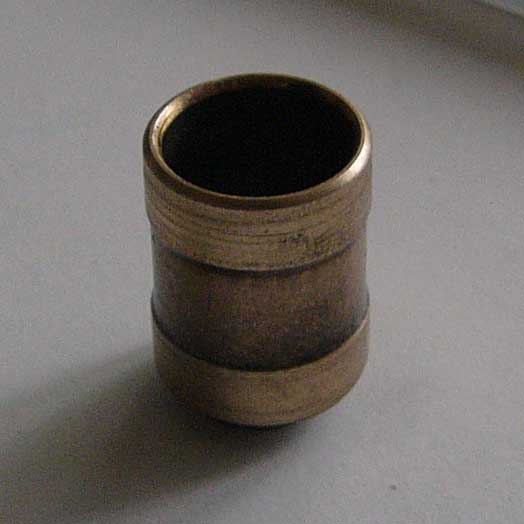

Hi there...
Does anyone have spares of this part of the pressure relief valve on the front firewall???
My seal was mangled.
Ron
(Hope the attach works..)

PostPosted: Thu Apr 05, 2007 11:50 am    Post subject: Yak 52 Pressure relief valve???? RFS Reply with quote
Except for the "W" models of Yaks (52TW for example) and some of the
very late model Sukes, the guts that are INSIDE of the pressure relief
valves in CJ's, YAK's and Sukes are all the same.
You can purchase a CJ pressure relief valve from Doug Sapp ... And all
the parts INSIDE of the valve, along with the part that screws on and
regulates the pressure will work.
The OTHER method is to purchase this little kit, that allows you to GLUE
a new piece of rubber on the top of your old brass slider valve seal end
and get it to work THAT way.
Personally, I went with the valve from Doug.
The BEST solution .... Which is WAY WAY pricey... Is to purchase an
American made pressure relief valve and replace the Russian one...
Price.... $750. But... It lasts pretty much forever.
Mark Bitterlich
N50YK
