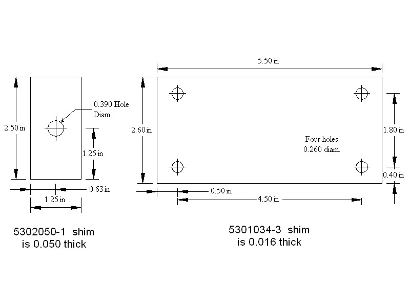

I have a couple of drill bushings and a reamer that will help you drill the new bolt hole in the vertical webs... want to borrow them? I think that is the most critical part of the process.... fore and aft location can be fixed with shims with a Tiger part number... I have those drawings too, JPG copy attached...
Pics are in this directory....

As for drilling and shimming to make the stub spar fit the vertical
braces, I plan on clamping the vertical braces in place with the
horizontal and stub spar installed before I drill any holes. That way,
the braces will be tight against the stub spar.

Hope you didn't take too much of the 0.025 off...:^) - or is 0.032 there?
As for drilling and shimming to make the stub spar fit the vertical braces, I plan on clamping the vertical braces in place with the horizontal and stub spar installed before I drill any holes. That way, the braces will be tight against the stub spar.
Yes.. but it's hard to hold the verticals in alignment while the glue dries... at least to the accuracy to not have anything under stress in the final assembly.
Once the verticals are bonded and riveted, then it's easy to use C-clamps and get levels on the horizontal for alignment... as well as tip measurements to the fus. centerline to get no sweep forward/sweep back....
My plane had shims on one side - I think the fus. side - already...
Do you want the drill guide and reamer for the two big holes?
That seemed to be the hardest part to me - I bet most folks would just use a big drill bit and screw up the existing hole in the stub spar...:^(
I like all my bolts to be a nice slip fit if possible...:^)
