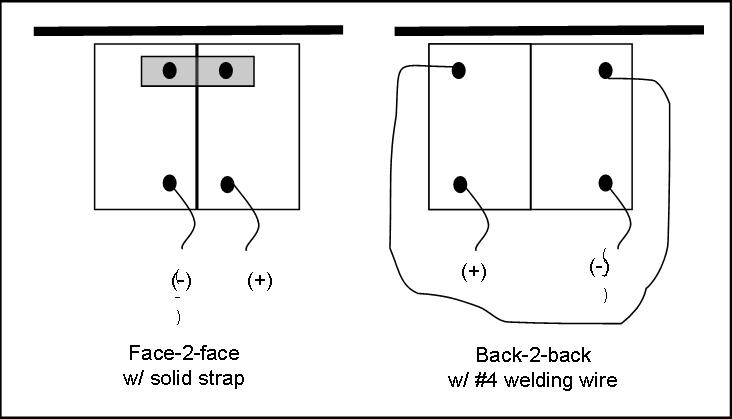

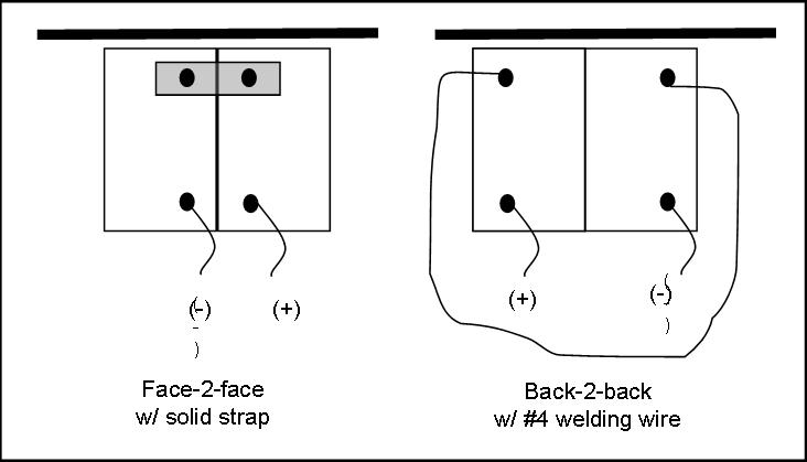

I'm not against #4AWG and crimped/soldered ends, but when placed face-to-face, the battery terminals are only 1.5" apart. The top terminals are in a recessed area (below the top battery surface) and thus really only accessible from the sides (see attached photos.)
The short side of the batteries are nearly flush with a bulkhead (~.25” gap), so the terminals are then really only accessible from the long side.
If I tried to make a #4 AWG wire to connect the face-to-face pair, them the crimped/soldered ends would been less than 1/4” apart (essential the ends would just be soldered together, stiff).
I could make a vertical "omega" strap, but if the paired batteries are secured together, I'm not sure I see how the two posts vibrate relative to each other? Rather, I was thinking that the terminals are only exposed to the load(s) due to attempting to accelerate (vibrate) anything connected to them. The direct connecting strap would be relatively light and so little load would be imposed to the terminals. Furthermore, I’m thinking that connecting something solid to both terminals cuts the force imparted to each in half. ???
The K&S suggestion is helpful. I was thinking that I needed something thicker (i.e. 1/8")
As an alternative, I could arrange the batteries back-to-back, but then the connecting wire would need to run around the outside perimeter (> 18”). Perhaps that is best???
Additional thoughts/comments???
Rick

PostPosted: Wed Apr 04, 2007 3:10 pm    Post subject: 12V batteries in series Reply with quote
little load would be imposed to the terminals. Furthermore, I m thinking
When you have two chunks of lead like these
you only 'think' you have them strapped together.
It's not the weight of the strap but the weights
of the two batteries and the inability to make them
absolutely immobile to each other for all modes of
vibration.
thicker (i.e. 1/8")
No, nothing nearly that thick. All I can do is
give you best practices based on having torn a lot
of stuff up in qualification testing that I thought
was pretty robust. Give it a try. What you've proposed
will probably be okay.
