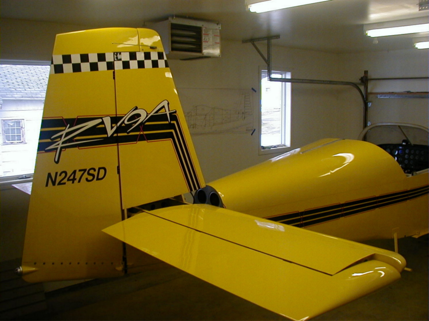

I'd like to leave the top and bottom hinges at the fire wall and change the side hinges to Skybolts C-loc style. These are very close in style to the Camloc brand they seem tighten better. My big concern is whether you think I will have a problem installing the top cowl into the top hinges while inserting the side loc style? Here's a shot of my RV-9A.

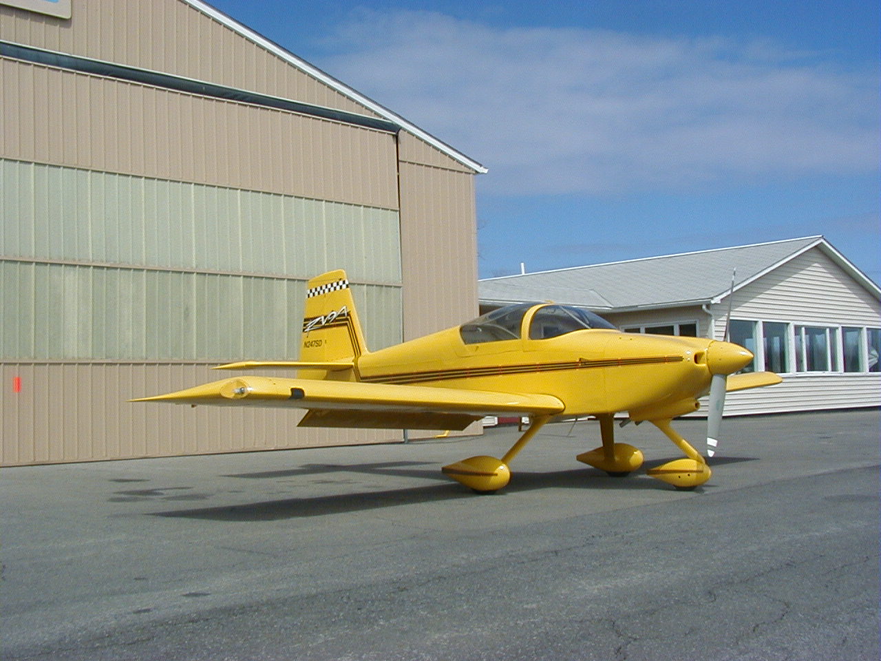

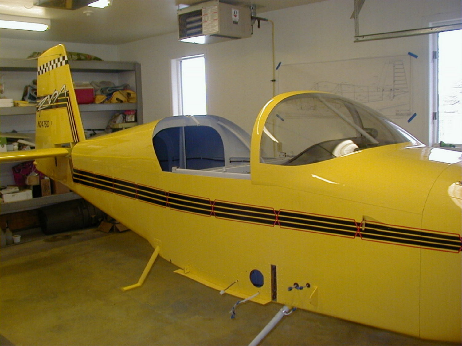

Bill, I ordered the Skybolts cowl package today should have everything early
next week. I've attached some more shots to help you better see the art
work. Everything is painted, I used a single stage paint from PPG called
Concept you can clear coat it but I was so impressed with finish I didn't
bother. To get the art work I went to a vinyl graphics shop one of those
places that designs those large colorful graphics you see on big power
boats. I knew what I wanted and approached the guy thinking I was going to
have him create a vinyl stick on for me. He explained that he could also
create a stencil that I could paint on. We created the design on his
computer and he came to my house and attached the stencil to the already
yellow painted plane. I would next pull off the areas I wanted a particular
color, paint it and then I would actually replaced the stencils over the new
color then I did the same to the next color. It took a lot of time but it
was worth it now there is no vinyl to come off. I painted the plane myself,
when I was a kid I painted a car so I figured I was experienced enough. I
built a paint booth in my two car garage (you can still see the paint over
spray on the floor) with fan and filter on oppisite ends and used a Hobby
Air unit for fresh air when I was in the booth.
Oh by the way he charge me $500.00 to create the stencil and come to my
house and install it. I still owe him a ride (he's on the list with many
others).
Also it flys like a dream with a Lyc 160 HP fixed pitch prop VFR day/night.

It sounds like you did it "right" by using the stencils and the results
really show.
