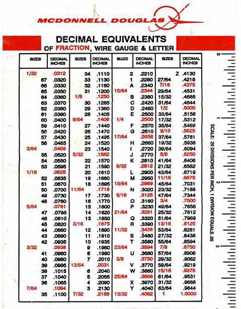

Bruce;
Most pulled or blind rivets by their very nature are not as strong as solid rivets. To give them all the help they can get blind rivets should be inserted into a prepared holes that are very close to their diameter.
You ran into a typical situation that is easily resolved by investing in a cheap digital micrometer and a drill index chart. Enclosed is a copy of my favorite chart. I find I refer to both tools often for one task or another. If you measured the MK-319-BS, you would find it mics out at approximately .110-.111 in diameter. The dimpling operation opened up the material just a bit. Therefore, the correct drill bit to prepare a hole to accept a MK-319-BS is 7/64."
http://img376.imageshack.us/img376/5454/img153pr3.jpg
