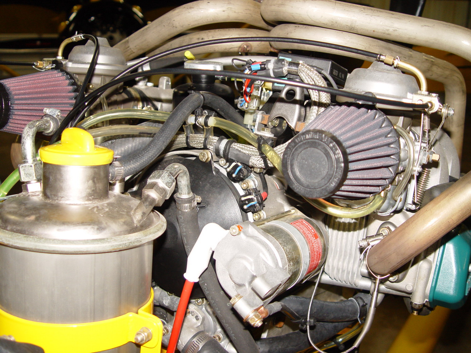

Here is a pictre of mine.

But..............your fittings are the old style, like I had on my
last engine.
