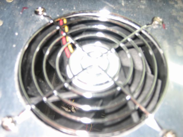

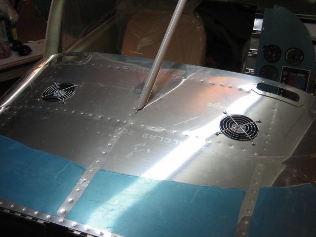

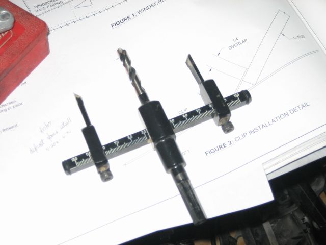

Deems: Just installed my fans last week. Bought 92mm Silverstone
computer fans and grilles from MicroCenter computer people.
Used fly-cutter in a portable drill to cut holes, just prior to
installing windshield. I find they put out more air than I expected;
probably could have used the 80mm fan size, and still have lots of
defrost capability, plus avionics cooling. See pics.

Looks good. The extra air won't hurt. I think I used 80mm
fans myself. One bit of advice though....you'll definitely
want to toss those chrome grills and replace them with something
dark. I've found that ANYTHING on the glareshield that's shiny
is going to reflect really bad in the sun. I shopped around
for black grills, and I painted my screens black too. I
added the screens just to keep junk from falling behind my
panel and into the fan.
One unexpected issue I had with my fans that depending on
the location may affect people.... I wanted the fans
mounted away from the center of the windshield, so they
would blow in distinctly separate areas. The glareshield
was curved in that area. I found that although when I
installed the fans they worked well, after a while my
fans started to buzz from blades rubbing the housing. That's
because they were warping to fit the glareshield curves.
So, I used some 1/4" or 3/16" plexi painted black and
made some standoffs that I sanded in a slight curve on
the top side, so the angle fit the panel good, yet left
a flat surface for the fan to mount to. That made all
the difference in the world.
My original fan was a single center mounted fan that I
can't remember if it was 50mm or what, but it was too small
and too weak. You'll want one that blows pretty good.
Phil, yours will work just great I'm sure. Can't hurt
to have them on the big side.
