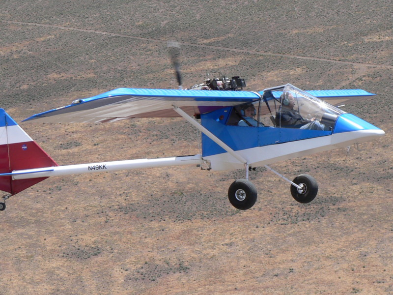

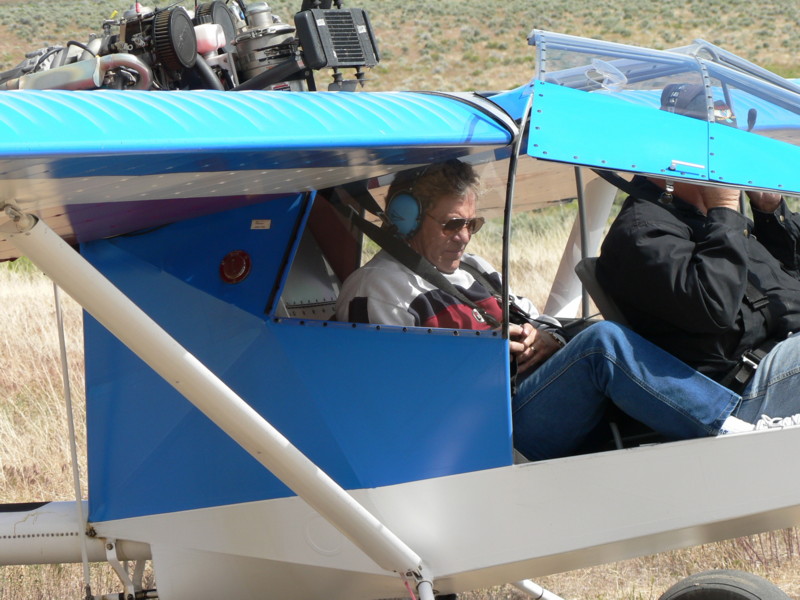

I think where you went astray is the assumption that the depression between ribs is due to "oncoming air". If this were true, it would be a no-no. The depressions are a natural result of shrinking the fabric over the Kolb wing. Take a good look at the on ground and in-flight pictures posted on this site and others and you will see that the depressions do not change from "oncoming-air". I did a quick search of my pictures and found these two shots that might help prove my point.
 Filesize:  143.85 KB
 Viewed:  349 Time(s)
 Filesize:  182.71 KB
 Viewed:  362 Time(s)
Roger in Oregon
1992 KXP 503 - N1782C

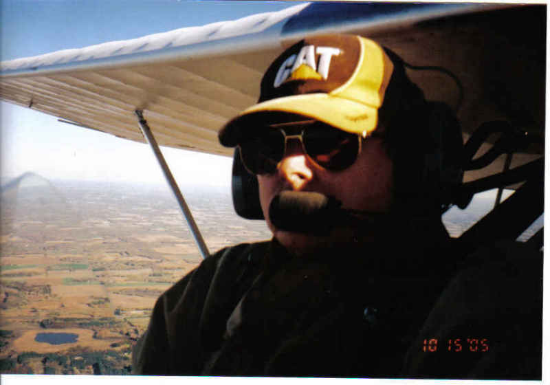

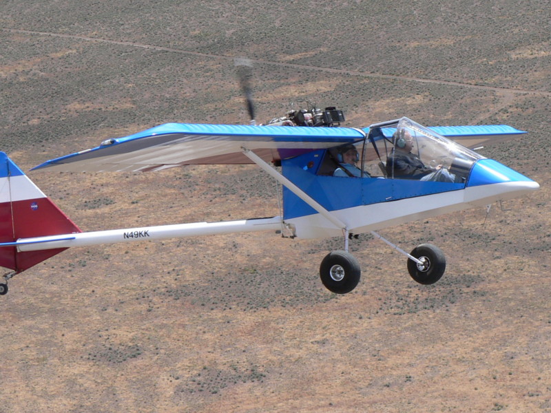

PostPosted: Fri Mar 23, 2007 1:40 pm    Post subject: Re: Leading edge deformation Reply with quote
Was this the picture ???
Gotta Fly...
Mike & "Jaz" in MN
 Filesize:  34.72 KB
 Viewed:  344 Time(s)
mdnanwelch7(at)hotmail.co
PostPosted: Fri Mar 23, 2007 3:32 pm    Post subject: Leading edge deformation Reply with quote
To Mike and Jaz,
Wow!! Yes, that is the picture I was referring to. Boy, it sure
doesn't look near as bad as I remember. Plus, the shadowing excetuates the
depressions, making them look a little worse than they obviously are. (Which
aren't that bad after all.)
Thanks, Mike, for doing the research and helping me see that this
situation really isn't an issue, at all. Livin' and learnin'
...... Thanks for you guy's help! Mike in SW Utah
