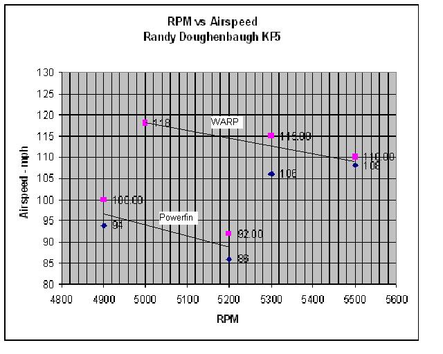

Bob
Joined: 24 Oct 2006 Posts: 89 Location: Damascus, Maryland, USA
Posted: Fri Mar 23, 2007 4:42 am Post subject: Re: Best prop was: Fuel consumption based on gallons per h |
Hi Randy -
I'm building an early 5 and it looks like you've done what I'm trying to get to. Great job on keeping the weight down! Being an engineer, I really appreciate the data and hope that you don't mind my plotting it. That really IS a huge difference between props!
Bob
