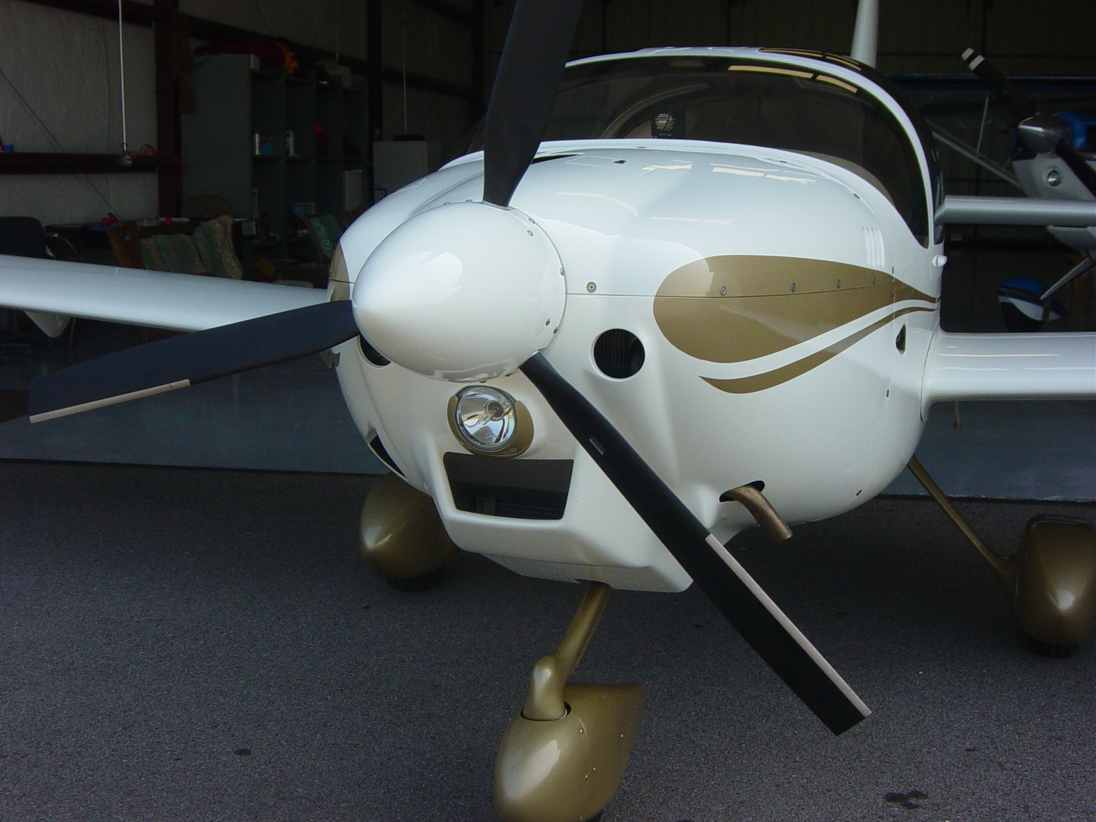

Hey Folks,
I have this landing lite that I want to mount in the cowling below the oil
cooler which is now below the spinner. I don't have the engine in place at
this time. The light is about
2 1/2" in diameter and about 3 inches deep depending on how I mount it. Has
anyone with the classic cowl put a light there? Any ideas on lens material I
can fair into place at this angled area? Will I need to make it protrude out
of the cowling, forward? Or, is there room to keep it within the contours of
the original lines of the cowl. I am concerned about it hitting the oil
pump or something. I am trying to see if it is worthwhile re hanging the
engine one more time before I paint.
Thanks.

Hi Troy,
I believe I sent this picture in before. I have the XS cowl but
creating a flange was necessary and worked well for me. Hope this
helpes.
Jeff
