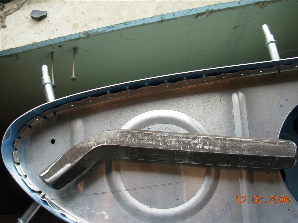

I had my best luck standing the leading edge upright when riveting the skin to the ribs, and reaching around horizontally. I did make a new bucking bar, although I have not tried it yet. It is 1” hex 12” long with the last 2-3” bent at about a 30 degree angle. (picture attached) I kept the flats on the side to permit the head to be close to the rib. I used hex to allow me to feel the rotation index. I also bought a tungsten bucking bar with one end beveled from Cleaveland tools. If I can shake this cold I will try the tanks this weekend, and see what works best. Smitty has a nice tank stand on his web site.
