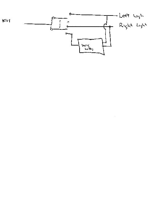

Working on the wig wag system using the B+C flasher.
What is going on inside that flasher?
I set it up on the bench with a DPDT switch. one side powers the flasher , the other the right and left landing lights.
the set up works as is, and the bench ohm meter read 4.5 Kohm between the two terminals.
The switched side of the flasher sees 14 volts when the landing lights are on, but I don't think that can present a problem. Based on this I this I don't think I need to set up the steering diode bridge, but thinking is not the same as knowing.

PostPosted: Mon Mar 12, 2007 5:28 pm    Post subject: Wig wag revisited Reply with quote
Bob
Sorry for the delay. I attempted to learn the express software for this, and simply could not get it off my clipboard. so here is the free hand version. Sorry about the quality but I think it tells the basics

PostPosted: Mon Mar 12, 2007 8:57 pm    Post subject: Wig wag revisited Reply with quote
Understand. What you've shown should function just fine.
