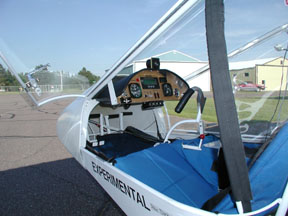

Greetings all,
My Kolb came with a straight center stick that didn't appear to be too pilot friendly. I modified the stick by putting a "rams horn" attachment to the top. This allowed me to fly comfortably with my left hand freeing my right hand for other duties. I am still building so can not comment on useability of the Y stick but would not hesitate to make a similar modification if I find it difficult to fly right handed and cross over with my left to operate radios, etc.
