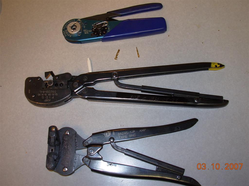

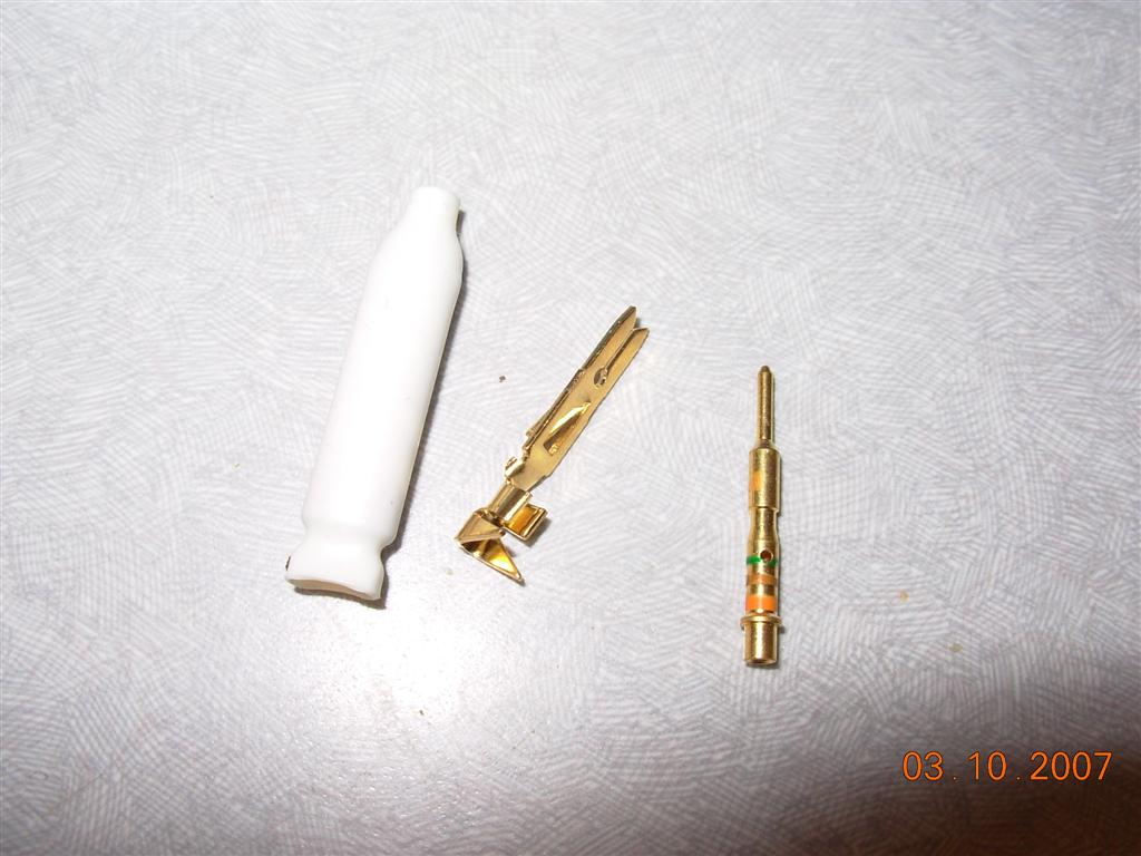

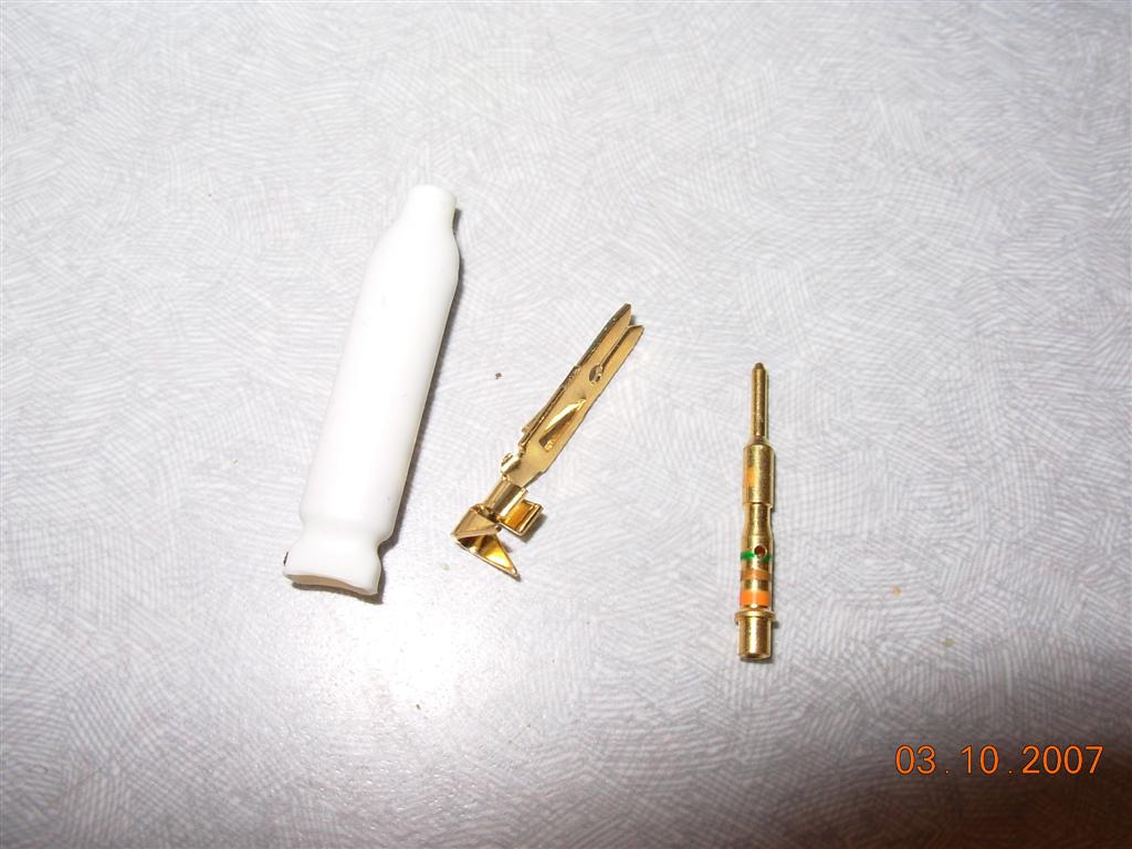

During the demolition of a nuclear plant a box of electrical tools were being thrown away.  I rescued the tools even though I did not know what they were. I did recognize the terminal ends and knew to clear ones were better (PIDG) than those at Wall-mart. Thanks to your web site I now know one was an AMP T-head and how the terminal end is positioned. However I do not know just exactly what the other tools are, I suspect one is used on 10-12 size terminals, and how they are used. I also have some unknown electrical connectors. Can some one tell me what these are and how they are used. Pictures are attached.

The blue tool is a universal 4-quadrant crimper
for machined pins. The knob on the handle sets
the crimp depth for various sizes of pins. You're
mission the suite of positioners that hold the
pin in the right location for applying the crimp.
Each style of pin has its own positioner.
The 59239 tool is for yellow PIDG terminals
and splices for 10-12 AWG wire.
The 59245 tool is for installing the center conductor
pin of some coax connector.
I don't recognize the parts in the other photo.
