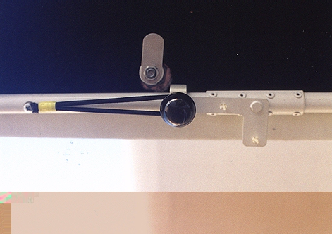

PostPosted: Thu Mar 08, 2007 6:33 am    Post subject: Door Locks? Reply with quote
Nick, I installed locks in both my doors using cam-lock mechanisms purchased from a lock shop. I had them keyed the same for simplicity. By attaching a small piece of aluminum to the inside handle of the door latch, the cam-lock can be used to secure the door without hindering normal door operation when in flight. See attached photo.
Also here is a link that will show some of the many cam-lock options available.
http://www.monroeengineering.com/locks/Cam-Lock/index.htm
Bill W.

I like your setup, I had the same in my IV less the bungy and the lock. One thing I added to mine was another latching leg alongside the one you have that goes down along the inside of the fuselage holding the door closed. It was positioned farther in towards the seat to allow the original one to go on the outside of the fuselage and the new one on the inside, this would hold the door about a half inch open for those hot days that you wanted to get a little breeze but something that would not blow everything around the cockpit.
Lloyd

PostPosted: Thu Mar 08, 2007 6:46 pm    Post subject: Door Locks? Reply with quote
Thanks Lloyd, I may give that a try.
Bill W.
