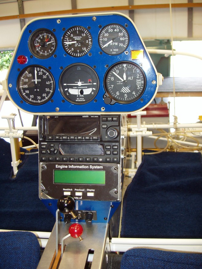

John, I have the Garmin 327 in my Kolb, I like it. Yes it's overkill but it
looks good. I fly out of class D under B in the mode C veil.
