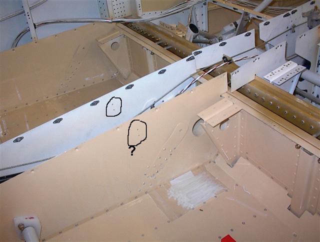

Extra Holes in Aft Tunnel
Albert Gardner
Posts: 455
Location: Yuma, AZ
PostPosted: Tue Feb 27, 2007 12:23 pm    Post subject: Extra Holes in Aft Tunnel Reply with quote
There are 2 small holes in the aft part of the tunnel that are still empty. They are located near the flap motor, near the top of the tunnel and are arranged in a vertical pattern. They show up in the plans from place to place but I can’t see what they are for. Early on I thought they would be for rudder cable guides but if they are I have overlooked installing them and they don’t seem to be lined up correctly if that is the intended use. Any help would be appreciated.

PostPosted: Tue Feb 27, 2007 12:49 pm    Post subject: Extra Holes in Aft Tunnel Reply with quote
I would need a little more detail. The rudder cable holes are in the top corners of that area, and side by side, not vertically aligned. Do you have a picture? What size are the holes? Someone with that part open will probably be able to help more.

PostPosted: Tue Feb 27, 2007 1:12 pm    Post subject: Extra Holes in Aft Tunnel Reply with quote
There are 2 small holes in the aft part of the tunnel on each side that are still empty as I well along in construction. They are located near the flap motor, near the top of the tunnel and are arranged in a vertical pattern. They show up in the plans from place to place but I can’t see what they are for. Early on I thought they would be for rudder cable guides but if they are I have overlooked installing them and they don’t seem to be lined up correctly if that is the intended use. Any help would be appreciated.

PostPosted: Tue Feb 27, 2007 1:36 pm    Post subject: Extra Holes in Aft Tunnel Reply with quote
Albert,
The holes are for rudder cable guides - See page 38-9. Installation is not mentioned in the instructions, but they are in the drawings. I have seen several web sites with these guides missing.

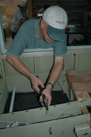

PostPosted: Tue Feb 27, 2007 2:20 pm    Post subject: Extra Holes in Aft Tunnel Reply with quote
OK, now I see. Little holes, like #40 holes, on the side of the tunnel, not on the bulkhead. They are being riveted in the attached picture. The part is F-1016H and can be found in the plans on page 38-9.

PostPosted: Tue Feb 27, 2007 2:25 pm    Post subject: Extra Holes in Aft Tunnel Reply with quote
OK, I’ve attached a pic and circled the holes in question.

PostPosted: Tue Feb 27, 2007 4:58 pm    Post subject: Extra Holes in Aft Tunnel Reply with quote
Yep, one of those sites would be mine darn it. Nothing worse than having everything all hooked up and realizing you forgot them. Smile

PostPosted: Tue Feb 27, 2007 6:20 pm    Post subject: Extra Holes in Aft Tunnel Reply with quote
Hahahaha. It’s funny because those little aluminum pieces for the snap bushings are the ONLY pieces in my entire aircraft that weren’t primed with AKZO primer because it was late, and I discovered it as you did in the plans picture only, and I had already run the cables, so I cheated and shot it with a lesser rattle can primer. The only grey primer on the aircraft. Probably one for the gotcha page.

PostPosted: Tue Feb 27, 2007 6:41 pm    Post subject: Extra Holes in Aft Tunnel Reply with quote
They almost 'got' me (and Tim O) too - see <http://www.myrv10.com/tips/gotchas.html>
BTW Mine don't have the BMS 10-11 Super Anzapon green primer either - they have rattle can grey Smile
