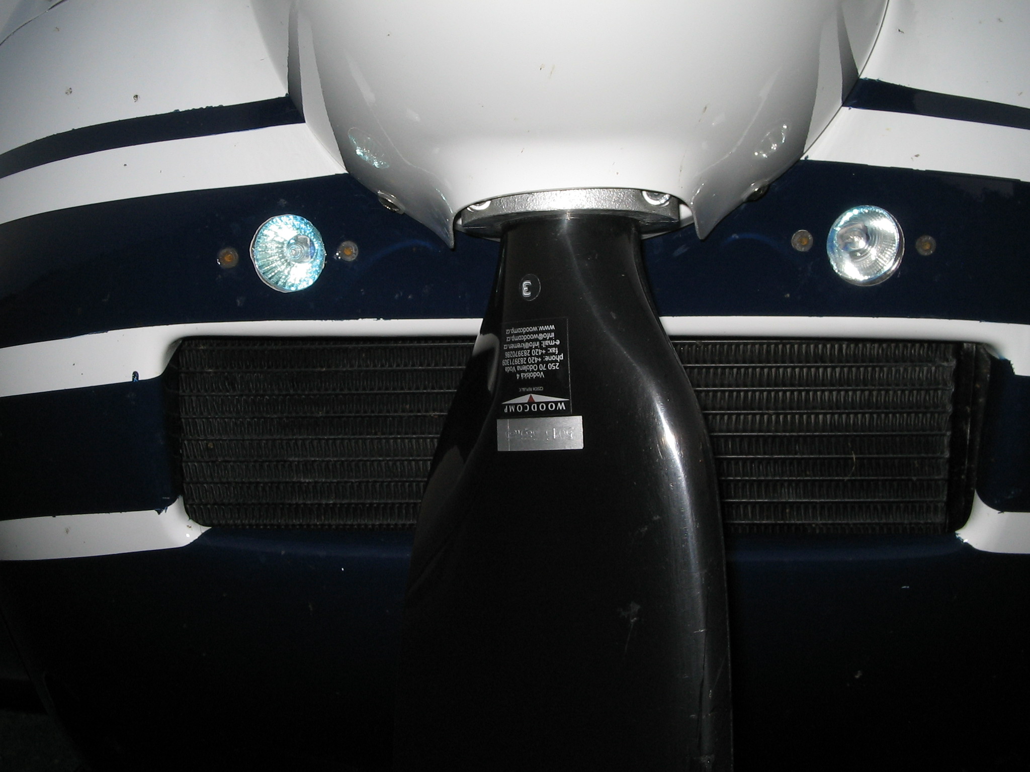

i have installed 12v halogen bulbs from home on my 601 same could be done on 701
mounted them in a perspex housing total costs 3,--usd

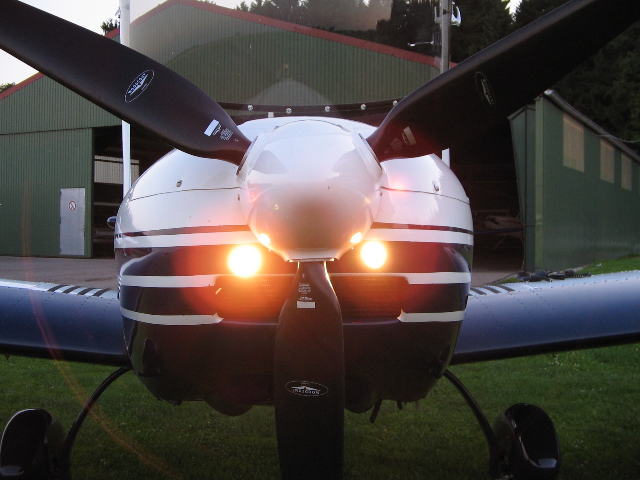

PostPosted: Sun Feb 25, 2007 10:52 am    Post subject: Re: CH701 Landing Lights Reply with quote
pic 2
