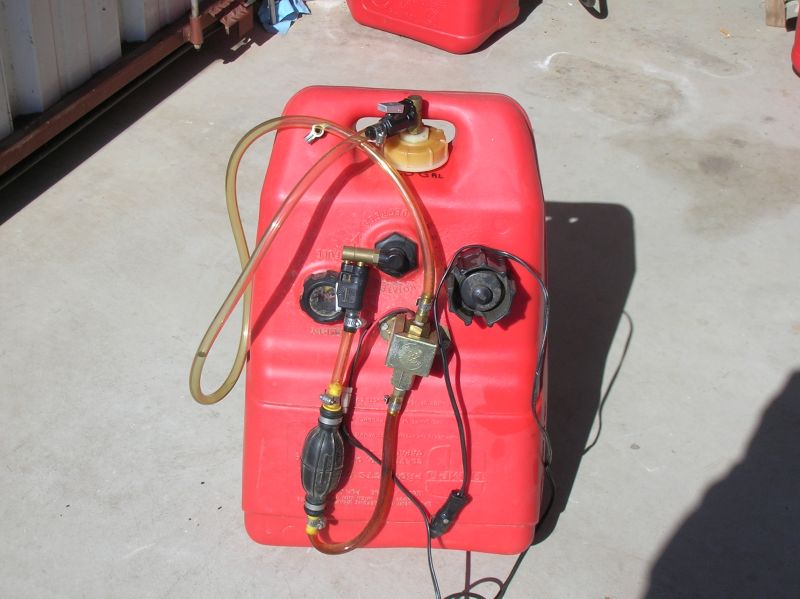

Pretty much as detailed by Planecrazzy. A common boat tank, a Facet pump and some connections. Holds almost seven gallons giving my Mk3 about three hours range and a twenty minute reserve with 17 gallons total.
