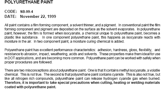

Guys
One of the things that seems not to be known by anyone that I have
talked to over the years, is the composition and technology behind the
covering and finishing systems that we use on fabric planes..
Surely someone on the net can tell us how to make our own paints?
I think we have seen most products go up 10 to 20 percent this year..
Seems like a good time to try to circumvent the Aircraft coating
companies.. 200 dollars a gal seems absurd to me..
Here is a little blurb..
Herb
