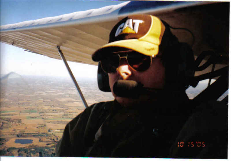

Hey Ron,
You know the next plane I'm building will cruise around
200 mph....it has fabric on the fuselage and tail....They use 2.7 oz
On my Firestar I have 1.7 oz....but I'm 3 times slower
Seems to me that 1.7 oz is plenty strong after the poly soaks into it...
although , in this picture you can see how it stretches and bows between
the ribs...
