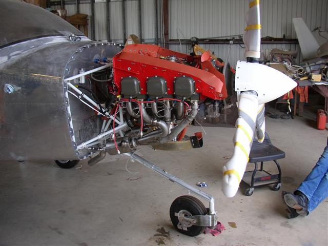

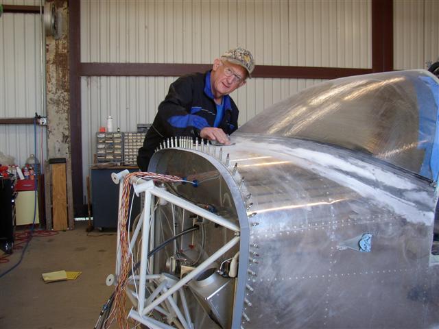

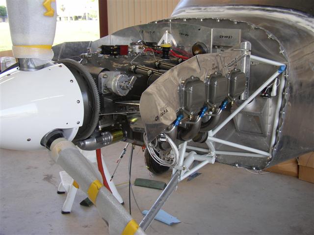

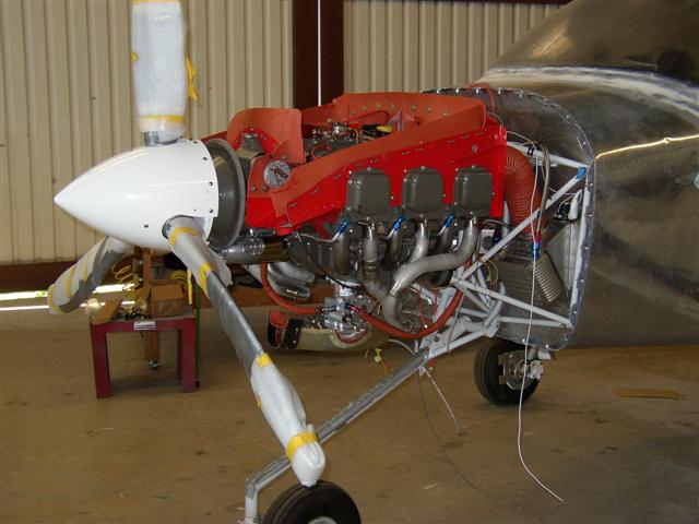

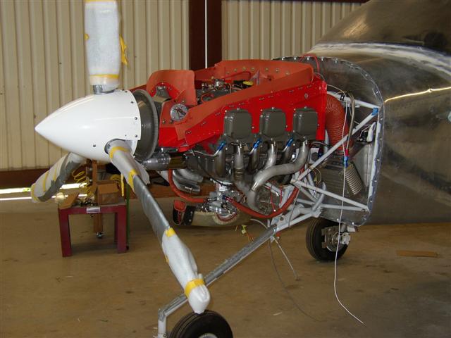

Niko,
This is the best I can come up tonight. I used 1 3/4" .063 strip around the
fuse to mount the camloc recepticles. I believe you could use .050 which
would bend around the curves much easier. The cutouts between the
recepticles reduce weight and make bending the tabs down to fit the slope of
the cowling much easier.
Mark

Thanks Mark,
Nice job.
