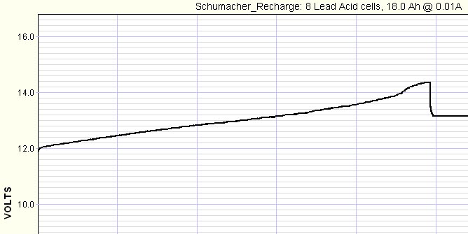

What were investigating here is an assertion supplied by
someone on the web that these smallest of battery maintenance
devices are unsuitable for use as chargers . . . i.e. replenishing
the energy in a heavily discharged battery.
The recharge profile measured on my Battery Tender Jr did
not have all the features offered by some other chargers.
I've attached a snippet of the trace on the Schumacher recharge
profile just completed. It topped out at 14.4 volts, only
about 0.5 volts higher than the Battery Tender Jr. At this
point in the recharge cycle, the battery is accepting only
hundreds of milliamperes of recharge current so these "dwells"
at the top-off voltage don't represent much total energy.
But in this case we do see the upward inflection in voltage that
begins right at 14.0 volts.
This may account for the fact that BTJr's performance as
a charger isn't all that bad. It stopped pushing energy into
the battery at about 13.9 volts. We shall see . . .
