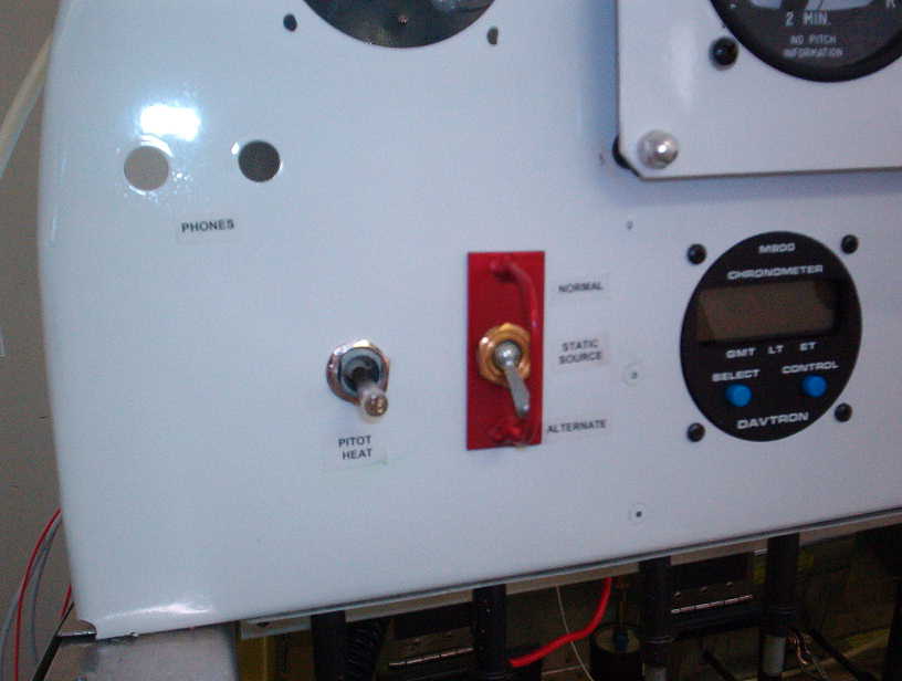

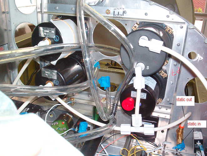

Mine actually came with my kit (no, I'm not an RV-10 builder), and I'm sure that you can get one cheaper from one of the suppliers listed above. Mine has 2 threaded fittings (static line in and static line out), and an unthreaded opening. In the normal position pressure from the static port just passes through the valve. In the alternate position, the line out is opened to cabin pressure. You could probably also use a valve with a single threaded fitting and T it into the static line.
