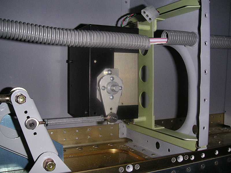

Where are people mounting their Trio or Navaid Autopilot servo's these days?
I see that www.safeair1.com has a wing tip kit for the servos but would like
some real world experience from you flying RV pilots. I want know if I
should order the servo before I close out my wing?
Anyone using the SafeAir1 kit? Is it worth the $130?
Scott R. Shook
RV-7A N696JS

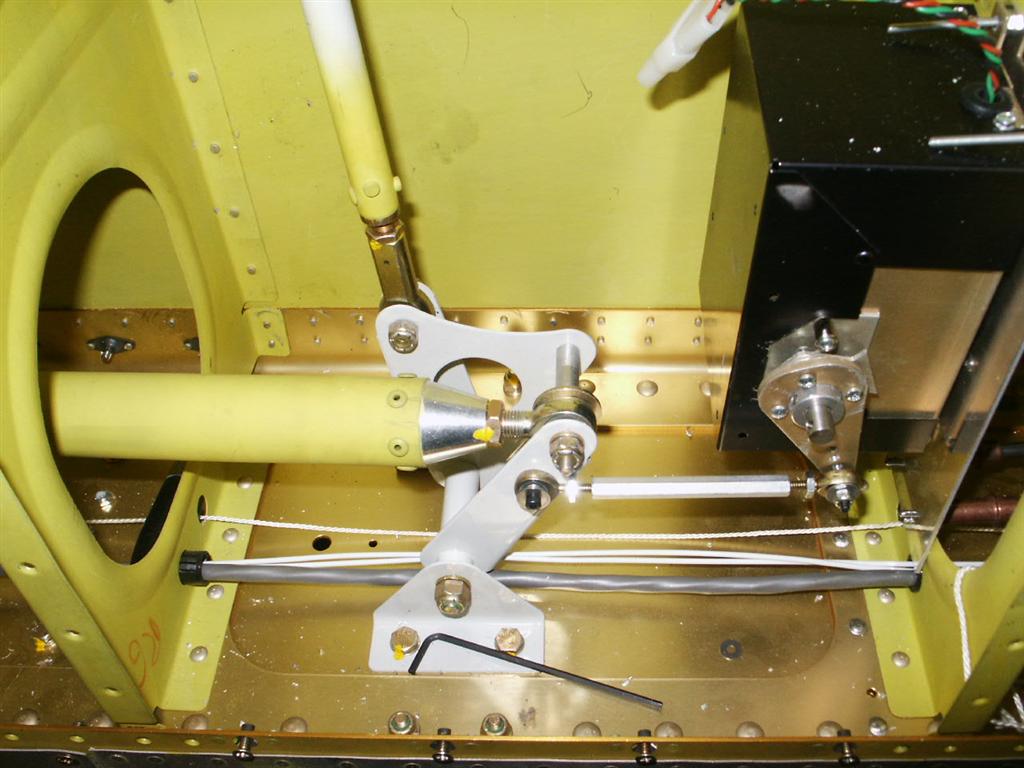

Scott, the Trio wing servo mounts very nicely on the rib next to the bell
crank. You fabricate a stiffener for the rib. I can take a shot and send
it too you or post it on my website. Their new servo is very, very nice.

PostPosted: Mon Jan 29, 2007 12:29 pm    Post subject: Trio Auto Pilot Servo Reply with quote
That would be great! A picture is worth a thousand words!!!

Here ya go. Just fabricate a couple stiffeners and you're good to go. You
can do it after the wing is finished but of course, it is easier before the
fact. Great company to deal with.

Forgot the link:-)
http://rvflying.tripod.com/wingap.jpg

I think you will like the safeair1 kit, I made my own and put the navaid
servo on the wingtip, and it didn't turn out
very good, after doing it this way , it takes a longer control rod , I
wished I would have put it inside the wing.
I thought It would be easier to work on.. not sure yet.. time will tell.
Danny..

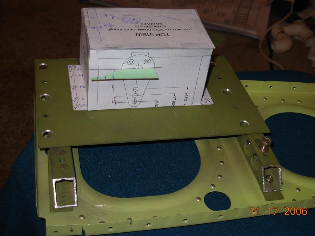

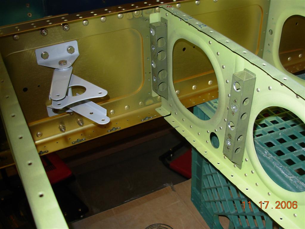

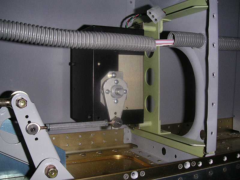

Hi Scott,
I have attached two pictures of my solution and two pictures from others. Also check Sams descriptions at <http://home.hiwaay.net/~sbuc/journal/index.html>.
Let me know if you are unable to see the pictures.
