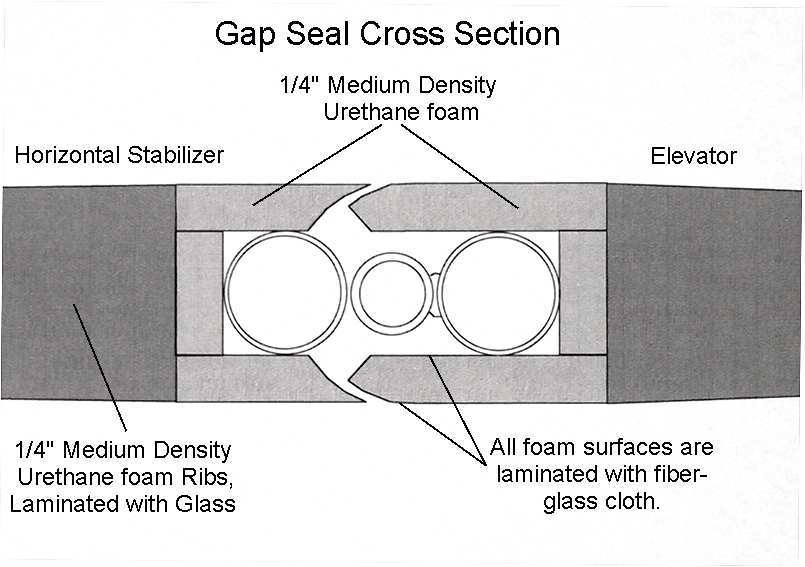

needed. The gap seal ws a bit more complicated. I am attaching a drawing
of the gap seal method I used.

Directly to your question, can you run an exterior link? Running a mechanical link out in the airstream on these slow little planes is often the easiest and lightest way to go.
Be extremely careful of potential problems with gap seals and anything else that may hinder elevator movement, especially remembering that the horizontal and elevator can flex under load. Cirrus lost an airplane and test pilot a few years ago when the tight fit of the aileron rubbed the trailing edge of the wing. Ice on a tight fitting hinge or gap seal can do the same, and the further you are from the center of the hinge, the more mechanical advantage you give to a blockage.
Bob
