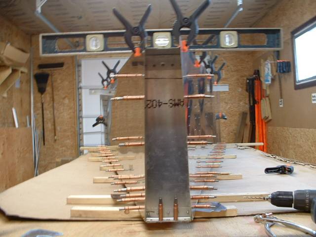

HDS People-
Attached is a shot of my rear former after adjustments. (It's fuzzy, I know). Note the top flange is the same configuration as the bottom. Also note that the longerons are right on track and the level bubble is centered.
3 hours to put things right, but zero outlay. New builders might want to set up after the side skins are on and make adjustments as necessary.
Bill Naumuk

Thanks for the heads-up, Bill.
Gary Boothe
Cool, CA
