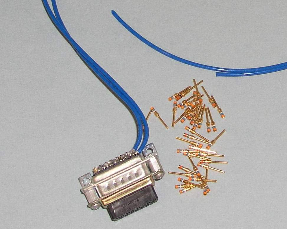

I took a solder-cup D-Sub female connector and soldered all the connectors
together and soldered one wire which went to the common pin on the intercom.
Then I put pins on all the shields and "Lo" wires and put them in a male
connector. At one time Bob had an article that showed this, but I couldn't
find it either.

PostPosted: Mon Feb 12, 2007 10:02 am    Post subject: Attaching Shield to "Lo"/Ground Wire at Intercom Reply with quote
Is this what you are after?
John Cleary
