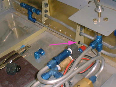

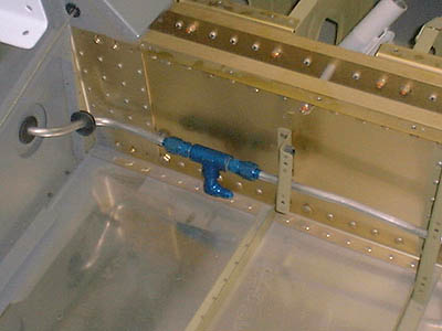

Not quite correct. Its not a full time return line, its only for use with the purge valve for flushing he fuel lines before startup.  It doesn't need to extend back to the tank. In my setup its T'ed into the right tank supply line just up stream of the fuel selector in the cabin. No changes to the fuel tanks required, easy to retrofit even on a completed plane.
g
dan(at)rvproject.com
PostPosted: Thu Feb 08, 2007 8:02 am    Post subject: Fuel Injection System Reply with quote
See the attached photos for what Gerry mentioned. Very easy to tee the AFP purge return into the fuel supply.
)_( Dan
RV-7 N714D
www.rvproject.com
www.weathermeister.com
 Filesize:  24.3 KB
 Viewed:  318 Time(s)
 Filesize:  31.97 KB
 Viewed:  315 Time(s)

PostPosted: Thu Feb 08, 2007 12:57 pm    Post subject: Fuel Injection System Reply with quote
Hi Dan,
I'm curious - in looking at your pics, why didn't you plum the return in
between the two backets?
/\/elson
RV-7A Fuselage
Austin, TX
~~ ** ~~ Research has shown that Mondays account for 1/7th of your time ~~ ** ~~
PostPosted: Thu Feb 08, 2007 1:45 pm    Post subject: Fuel Injection System Reply with quote
My philosophy was...the closer to the tank the better. I don't think it
makes much difference.
)_( Dan
david.nelson(at)pobox.com
PostPosted: Thu Feb 08, 2007 2:37 pm    Post subject: Fuel Injection System Reply with quote
Sounds reasonable.
/\/elson
)_( Dan

PostPosted: Fri Feb 09, 2007 4:25 am    Post subject: Fuel Injection System Reply with quote
If you plumb into your fuel supply system instead of the tank or vent,
then there is a possibility of contaminating the fuel supply with air
should there ever be a problem with the return lines. IF this happens,
the result is a loss in steady fuel supply to the system and potential
engine failure.
I have personal experience with this failure mode.
