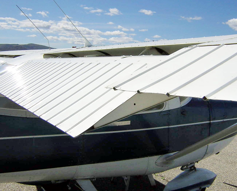

PostPosted: Fri Jan 26, 2007 1:18 am    Post subject: Re: Filling in the rib ends? Reply with quote
Hey Andy,
I'm assuming you're talking about the small gap left at the trailing edge of the control surfaces. If so, when I first started building I worried what to do about it. I went to a hanger and looked at production aircraft (Cessna, Beech, etc). I noticed they also had gaps between the aft end of the various control surface ribs and the trailing edge skin. Even a multi-million dollar Pilatus PC-12 had gaps. Attached is a photo of a Cessna 150 flap showing a pretty large gap.

PostPosted: Fri Jan 26, 2007 5:24 am    Post subject: Filling in the rib ends? Reply with quote
The gap is there for a reason. It simply allows moisture to drain.

PostPosted: Fri Jan 26, 2007 7:24 am    Post subject: Filling in the rib ends? Reply with quote
Another thing I forgot to mention is that if you do cover/close up the gaps at the trailing edges as I did, I think it is a good idea to drill a small #40 or #30 hole to allow the assembly to drip out moisture or "breathe". The hole is way too small for critters to intrude but large enough to drip out.

PostPosted: Fri Jan 26, 2007 9:09 am    Post subject: Filling in the rib ends? Reply with quote
Only my humble opinion, but the drain holes should be at least 1/4 inch.
Smaller than that blocks too easily. With the drill still in the hole, it
should also be sloped (pulled) backward when not rotating, enough that it
forms a slight negative pressure zone at the hole to suck any water out.
I agree - you don't want critters in there!

PostPosted: Thu Feb 08, 2007 5:39 am    Post subject: Re: Filling in the rib ends? Reply with quote
TxDave wrote:
Hey Andy,
If I misunderstood what you were describing, then ...never mind.
Dave Clay
Actually, I believe it's preferable to leave them open for drainage just in case water does get in there. It's not suppose to, but it can. It'd have to be perfectly sealed (welded) to never get moisture in there. The entire structure is link a fuel tank that breathes. Air is always going to get in there, and with it, humidity. You want that moisture to make it way back out too. Not only breathing of the structure but also, outright leakage, like with a car door. They always have drain holes at the bottom, or at least should. For appearances sake (and to cut down on rain water getting in in the first place), I'd say it's ok to fill the top gaps of say the rudder, but the bottom should be open, because the fuel tank-like structure will always breath in moisture and you don't want that moisture staying in there, you want it to run out.
