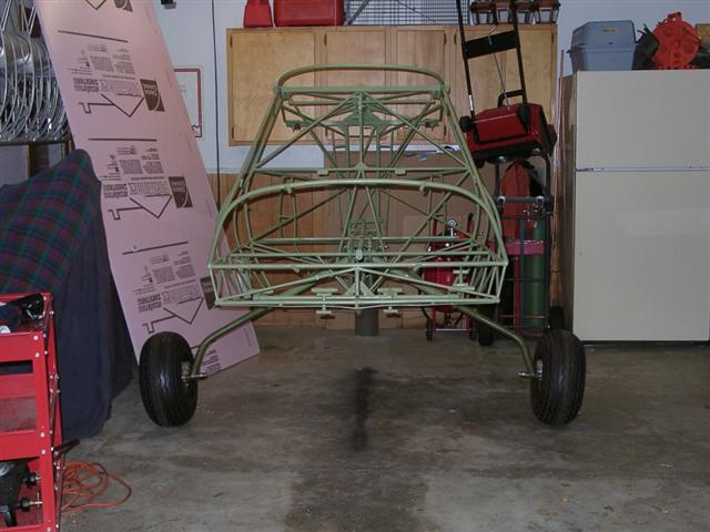

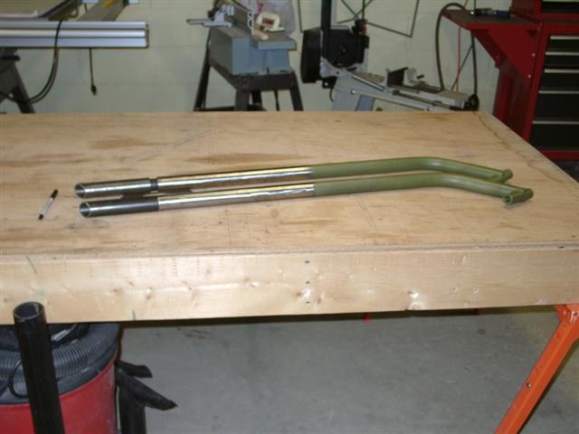

PostPosted: Tue Jan 30, 2007 7:33 am    Post subject: Re: Mk 3 steel main gear legs Reply with quote

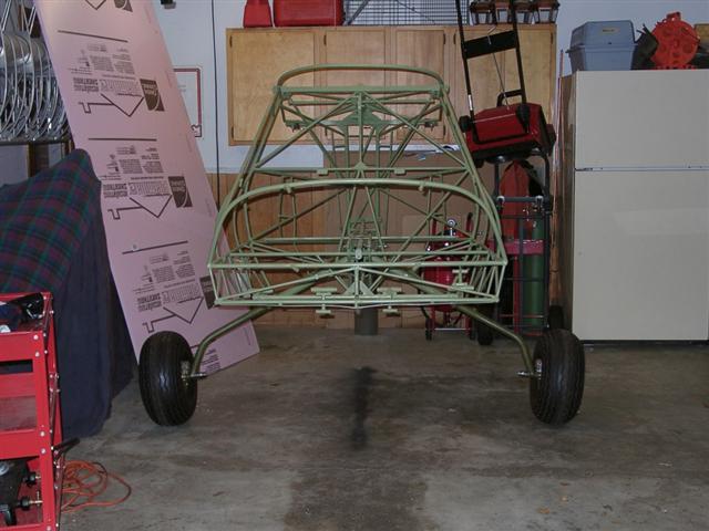

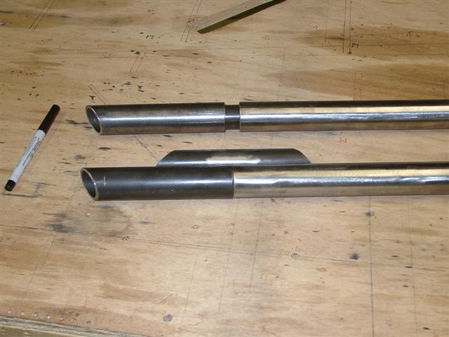

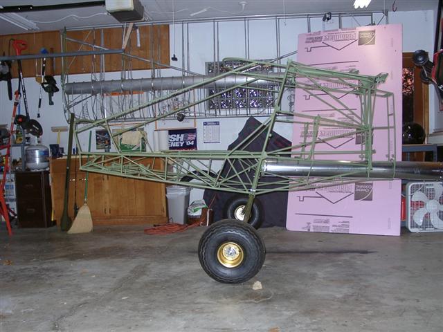

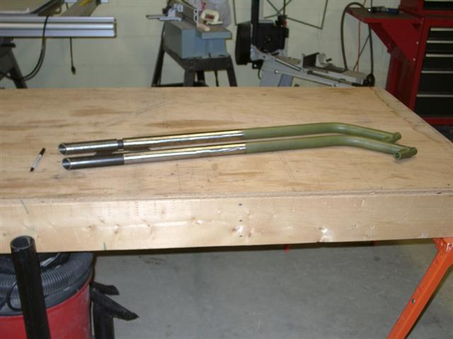

I think Kolb supplied two designs for the steel legs. A very flexible version (I think Steve Green has these); and a very stiff, heat treated version which I think is now the standard. I traded my old aluminum legs to Travis & bought the new, stiff legs. I installed extensions so they go up to the top of the "V" in the cage. I had to use carbide bits to drill these. They were very tough. The deflection is minimal.
See attached pictures for the extensions and the legs.

PostPosted: Tue Jan 30, 2007 8:31 am    Post subject: Re: Mk 3 steel main gear legs Reply with quote
Hi John,
My understanding is that if you take a piece of 4140 normalized and bend it it will deflect to the yield point and then deform. If you take the same piece and heat treat it (heat, quench and draw) to a higher yield it will then bend and deflect but will require a much higher force to bend the same amount and will therefore be stiffer (and also harder with the higher yield).
If I'm wrong on this let me know.

PostPosted: Tue Jan 30, 2007 8:48 am    Post subject: Re: Mk 3 steel main gear legs Reply with quote
Rex:
"Forgot to mention in previous post.
The heat treated legs will seem very stiff until there is some weight
on them. Once you get the engine, wings, fuel, and your body in the
airplane, the legs will get quite flexible. Without the weight, they..."
John,
I agree, I think we are saying the same thing.
Also, I did not change the wing incendence. These legs plus the fat tires will set me up higher so I'm closer to a 3 point stall landing, which I want.
Rex

PostPosted: Tue Jan 30, 2007 1:10 pm    Post subject: Re: Mk 3 steel main gear legs Reply with quote
| John, One of the things that helped make up my mind to not install
the steel
| legs is the need to change the wing angle of incidence (according to
the TNK
| document that came with the legs). Did you do this and if so, how?
| Rick
Rick:
No, I didn't do that. First I heard of it.
John / Rick,
kolb is suppling a new rear wing attach fitting that is slightly wider than the old one. This allows you to add washers on either side to raise or lower the trailing edge. I wanted these just in case I needed them for fine tuning. I think they were made so you could compensate for the new gear. Travis could give you the details.
Rex
Rex Rodebush
