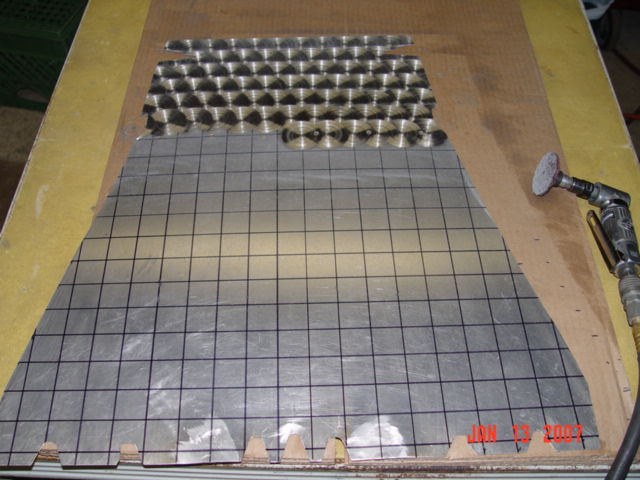

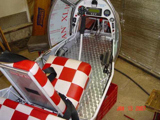

I've got some pictures of the process here...
http://wingsforum.com/viewtopic.php?p=5126#5126
Their easy to do , but I have a couple of "tips"
Gotta Fly...
Mike & "Jaz" in MN

planecrazzzy
PostPosted: Sun Jan 14, 2007 11:16 am    Post subject: Re: Fish Scales....Floor pan first....Then? Reply with quote
Hey Thanks!......( I think )
Those fish scales were done in only a couple of hours....
And I sewed my upholstery on a regular sewing mach....just bought upholstery thread & needle....
It's gonna take a little more for the windscreen....but the same thing could be done by just bolting /Riveting it together....
Main thing is....get inspired....make a wish list of things "ta do"
Gotta Fly...
Mike & "Jaz" in MN

planecrazzzy
PostPosted: Sun Jan 14, 2007 3:37 pm    Post subject: Re: Fish Scales....Floor pan first....Then? Reply with quote
Hi Bill,
It's an angle grinder with Scuff pads (2") The WD is put on to avoid
build up on the pad which would start gauling the aluminum....
The way I laided out the piece was about 1"x1" ( a little bigger )
In one row , I would center the pad where the lines crossed....
In the next row , I'd center in the middle , between the squares....
Next row , back on the crossed lines....
Below is a picture with the air tool in it....
Gotta Fly...

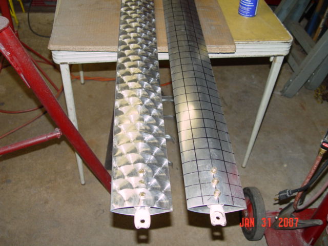

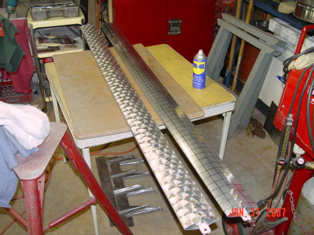

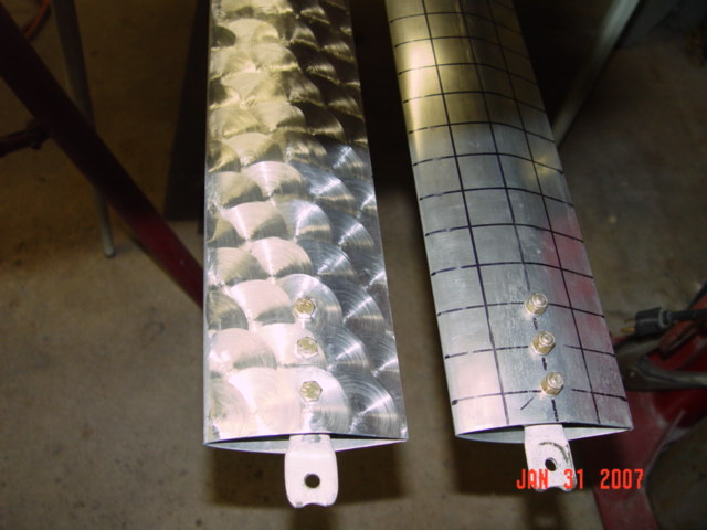

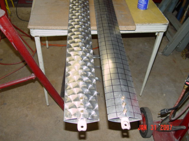

PostPosted: Wed Jan 31, 2007 3:26 pm    Post subject: Re: Fish Scales....Floor pan first....Then? Reply with quote
Well,
After looking at my Lift Struts....I've tried to polish them .... But they have to be handled so much , they get scratched up....
What hides scratches.....
These things weren't easy to do because of the curve that I'm trying to go around...
http://wingsforum.com/viewtopic.php?p=5291#5291
Gotta Fly...
Mike in MN
