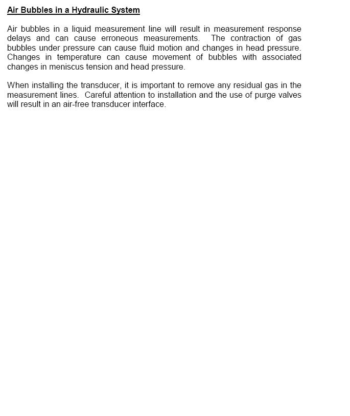

I think you are correct, Cappy. There are several states of gas that can exist in a liquid, some which cause worst effects than others, but in any case, they all appear to affect pressure measurements in a line to various degrees. Although, the attached refers to air in a hydraulic system the effects are the same in a pressurized fuel line. Note that bubbles can cause changes in head pressure as well as erroneous measurements and response delays.
Ed

I agree, Stormy, if you have a steady state condition. However, when the system environment is not static but dynamic then you can indeed have fluctuation states that cause the state in one part of the system to be different than another part.
Consider two rail road cars separated by a untearable bag of air,each car with a force measuring instrument (after all pressure is simply force over an area, right?). Then back an engine into the first car at some rate of speed. The first car will "feel" the impact essential instantaneously over its entire length and the force measuring device on the first car will register the force of the impact. However, at the same instant the force measuring sensor on the second car will register zero force. It will continue to register zero force until the pressure inside the air bag has increased sufficiently ( due to the compression forces) that the compressed air is able to transmit some force to the second car. Yes, eventually, the second car will measure the same force as the first car - but not instantaneous, there will be a delay. Now repeated back up the engine and ram the cars again and again and you have a rather chaotic and dynamic system with the air compressing, collapsing, rebounding, etc.
Therefore, you can have two different sections of the liquid (separated by bubble(s)) that see difference forces and therefore pressures varying in a dynamic manner. In a real fuel line the situation is considerably more dynamic than my example.
In a fuel line with multiple bubbles the situation can be complex. You have a pump that may be creating bubbles through caviation, you will have some amount of air bubble being re-absorbed back into the fluid, you have bubbles being created by pressure drops through fittings, temperature increases, etc. You may even have a leak that permits air into the system. So depending on the level your are viewing it at -what may appear to be a steady state system is its anything but a steady state system.
Air in fluid lines is generally not a good thing - just how bad the effect can - depends on a number of variables.
But, if you have had no problems - then I certainly wouldn't worry about all those little bubbles {:>)
