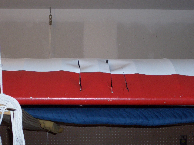

I have had an incident with the son-in-laws cats... please don't get me started on that.....
See the attached photo. one of them jumped up to get on the wing that was hanging in the garage and sliced the fabric.
Question: can these slices be repaired or should i recover the entire wing???
Thanks a bunch...

PostPosted: Sun Jan 28, 2007 3:02 pm    Post subject: Mark III Wing Fabric Repair... Damn Cats... Reply with quote
Break the cats neck!!!
Before I repaired the fabric I'd do a professional punch test on it.
If you covered and finished the wing with Stitts/Polyfiber products,
and there is adequate UV block, probably ok to repair.
We discovered some fabric on a FS that had very little rip resistance.
Virtually no resistance to tear. This fabric was finished with
something other than Stitts/Polyfiber products.
Best recommendation for me would be to call Jim and Dondi Miller for
answers.
http://www.aircrafttechsupport.com/
Take care,
Michael Sharp

PostPosted: Sun Jan 28, 2007 3:54 pm    Post subject: Mark III Wing Fabric Repair... Damn Cats... Reply with quote
That is a very serious part of the wing. Don't want to have a patch
release in flight.
I have patched fabric with less than 6" rips in that area with
success. I think an important factor is to have plenty overlap of the
damaged area.

PostPosted: Mon Jan 29, 2007 7:48 pm    Post subject: Mark III Wing Fabric Repair... Damn Cats... Reply with quote
First things first, cat soup is real good, taste just like rabbit.
Seeing what you have there I don't think you got that big of problem
other than just the pain of doing the repair. The biggest issue is
what kind of color top coat (paint) do you have on the fabric?
If it Aero-thane or enamel it may be more work, if it's Poly-tone, it
shouldn't be as bad. It gets down to if you have to remove the top
coat or if you can glue the repair fabric patch to it, if poly-tone,
it would be easier. As John Hauck indicated, talk to the Millers
about what they suggest to prepare the surface for the patch and what
to use to adhere the patch to the original fabric, poly-tac cement or
poly-brush based upon the type of top coat. Really it's not that
bad. Once you get into it, you'll have it done in no time.

PostPosted: Tue Jan 30, 2007 9:55 am    Post subject: Re: Mark III Wing Fabric Repair... Damn Cats... Reply with quote
Mike,
Are you sure a cat did this damage? I cant imagine a cats claw ripping the fabric like that. If so you must have some pretty mean cats sir!
Paul Petty

PostPosted: Tue Jan 30, 2007 10:36 am    Post subject: Mark III Wing Fabric Repair... Damn Cats... Reply with quote
Yes, the wings are hanging in the garage about 7 feet off the ground. There is the Son in Law's piano sitting underneath them. (another story) I imagine that one or both of them tried to jump on the wing and slipped causing the slashes.. The sweet kitties are about 12 lbs each... There are other marks on the top side, which the photo doesn't show, that is definite Feline sign...

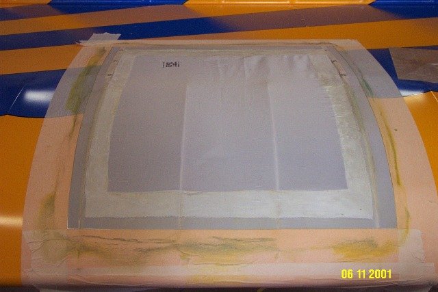

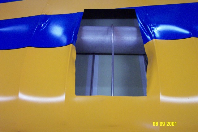

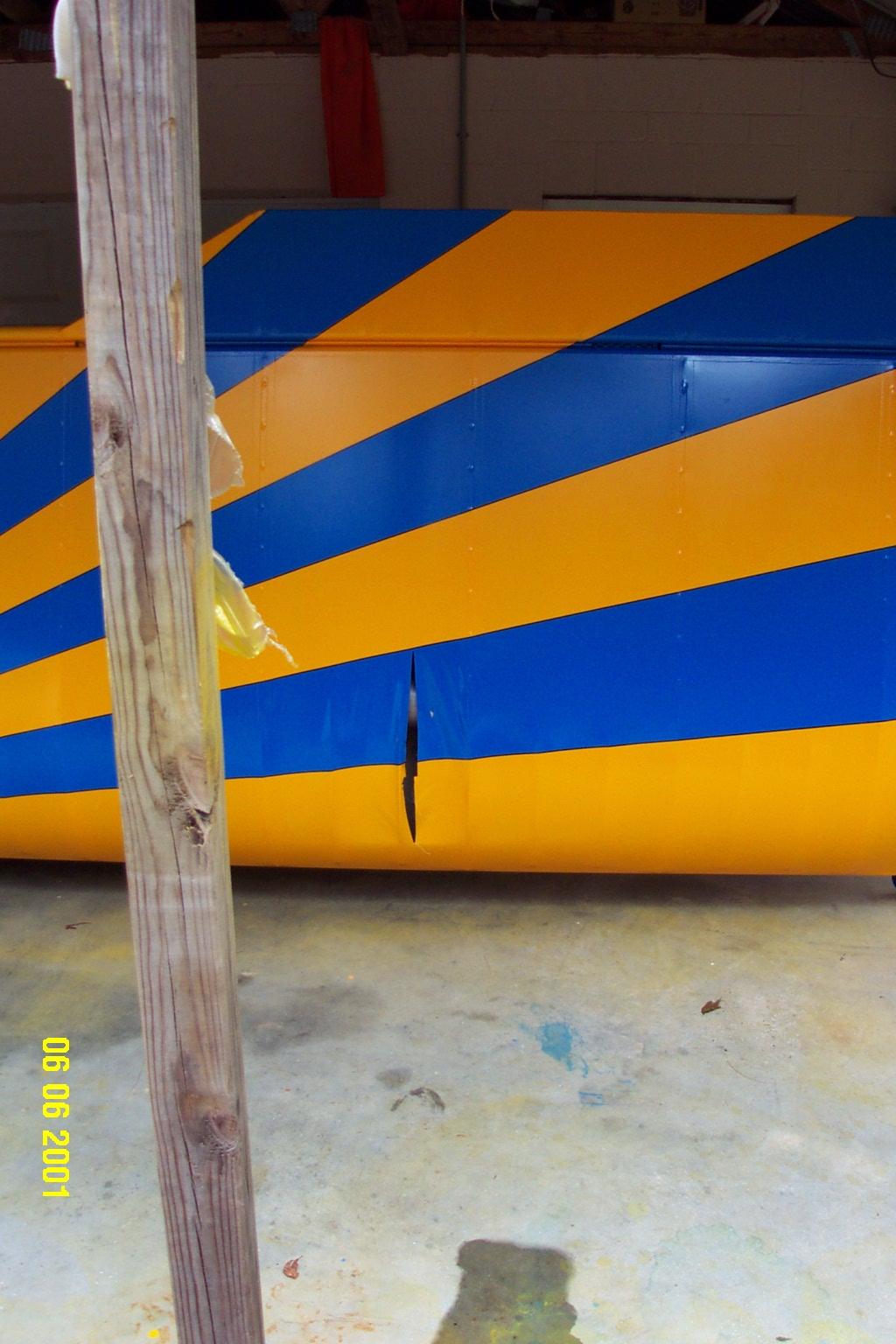

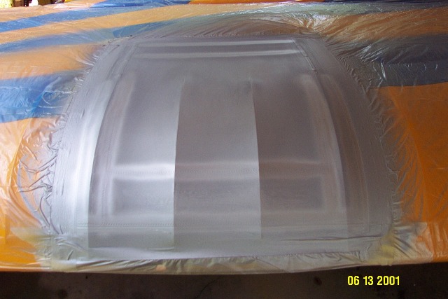

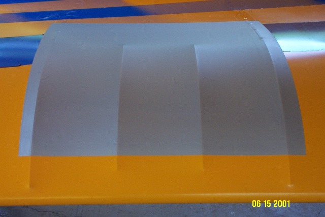

jcooley380(at)hughes.net
PostPosted: Tue Jan 30, 2007 1:16 pm    Post subject: Mark III Wing Fabric Repair... Damn Cats... Reply with quote
12lbs each?????!!!!!!! That's more like a bobcat or mountain lion. All you
folks suggesting the varmit calibers can forget it. Kitties that big need a
7mm mag.
I did have a similar tear in the top of my Firestar wing. It wasn't from
cats, it was self induced. I had the plane folded and under the open end of
my shop when a summer thunderstorm came through. The tailwheel was on a
small 3 wheeled dolly and a wind gust caught the wings and pushed them into
a 4x4 support post. The result was ugly and made me sick. The repairs, per
the polyfiber manual, are not too noticeable. Will attach a pic or two.

PostPosted: Tue Jan 30, 2007 1:59 pm    Post subject: Mark III Wing Fabric Repair... Damn Cats... Reply with quote
John C:
You did a good job on the wing repair. Really looks good.
Super important area for proper patching. To lose a patch in that
area in flight would blow all the fabric off the wing.
