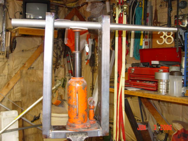

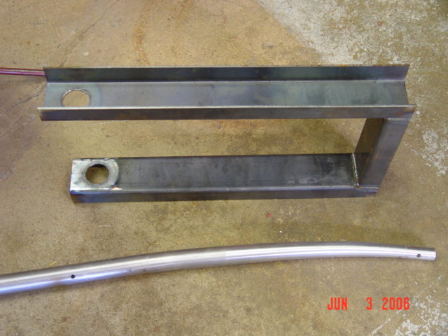

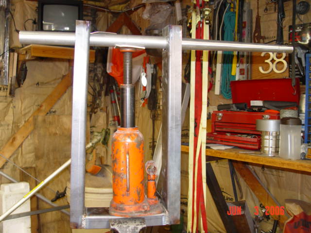

You really should stick with the aluminum gear....
it helps "save" the aircraft from damage....
The gear is easy to straighten or replace....I bent my right leg once
made a homemade leg straightener with a 12 ton jack....piece of cake
( see pictures )
