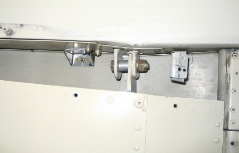

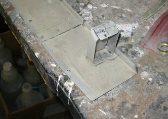

bbernard1945(at)sbcglobal Guest
Posted: Sun Jan 28, 2007 10:32 am Post subject: wing root fairings |
Okay, Okay, so I left the camera at the airport!
Here are a couple of photos to sort of illustrate what I was talking
about...
Bill

DHEDGE(at)kc.rr.com Guest
Posted: Sun Jan 28, 2007 11:24 am Post subject: wing root fairings |
Thanks Bill, the photos help.
WE layed up fiberglass yesterday on the top where there is more of a
compound shape. We will attach the lower aluminum pieces in a similar manner
to yours.
Dan
