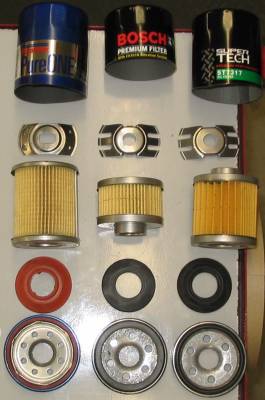

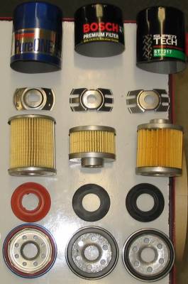

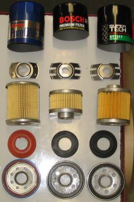

PostPosted: Thu Jan 25, 2007 7:13 pm    Post subject: Re: Best Oil Filter for the 912 Reply with quote
I have been researching Rogers post about oil filters and found the exact same results that Robert did. Motorcycle people are an excellent source for high performance engine information, and they gave the Purolator Pure One filter the best ratings in filtering out the smallest particles, the amount of filter media used, and construction. Some off road sites also came to the same conclusion Roberd did, Pure One beign the best, Mobil 1 being second, and down from there.... Check out the following websites.
http://www.calsci.com/motorcycleinfo/FilterStudy.html
http://minimopar.knizefamily.net/oilfilterstudy.html
http://www.calsci.com/motorcycleinfo/Filters.html#OilFilters
http://minimopar.knizefamily.net/oilfilters.html
I was hesitant to try a different oil filter in my brand new 912-s, and I could care less if the filter cost 5 dollars or 15 dollars, I just want to put on the best filter avialable. I called some Rotax mechanics and asked them about it, and they gave me the same line they gave Robert, " Use Rotax because of the higher bypass pressure "... Well the Rotax Bypass pressure is 13 PSI and the Purolator bypass pressure is 12 PSI, 1 PSI just will not make any difference...
Here is the Kicker, the mechanic said "you dont want to be in bypass"... The Purolator filter has a lot more media than the Rotax Filter, so even though it is 1 PSI difference, the oil flow through a lot of media in the Purolator is much better than through less media in the Rotax filter. So in the end, I am less likely to see bypass at cold oil temperatures or due to clogging in the Purolator filter. One thing some websites said is that the purolator has so much filter media, that they from looking at it they think it could impede flow as the pleats are close together, although there have never been any reported problems. If I were very worried about this, and wanted to be conservative and error on the safe side, I would use the Mobil 1 filter...
For those of you that use Fram filters in your engines ( I have used Fram in my cars for years ) you REALLY need to see the bottom of the page in the last link of the websites !!! Fram always rates in the lowest of the sites I have found, but this is scarey !!!
The easy thing for me to do would be to just buy the Rotax filter, but I want the best filter I can get. Falsely feeling good about a Rotax Filter just because they relabeled it and Rotax tells us all to use it does not make it the best filter. Look how long it took manufaturers to discover the advantages of synthetic oil and finally give us their "blessing" to use it. I have run out of reasons not to stick a Purolator filter on my 912-s after my first oil change. Any input from those that have been flying 912's for a long time would be greatly appreciated.
