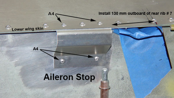

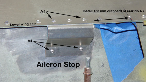

Tim Juhl
Joined: 21 Mar 2006
Posts: 488
Location: "Thumb" of Michigan
PostPosted: Fri Jan 26, 2007 8:56 am    Post subject: Re: Aileron stop Reply with quote
This is what the current XL plans show. The pictorial guide gives a different measurement outboard of rib 7 but the date on the plans is newer.
Tim Juhl
Aileron Stop

Martin Pohl
Joined: 30 Jan 2006
Posts: 118
Location: CH-8645 Jona SG, Switzerland
PostPosted: Fri Jan 26, 2007 10:31 am    Post subject: Re: Aileron stop Reply with quote
Hi Tim
Thank you for the picture of the aileron stop-installation. I will recheck my plans...
