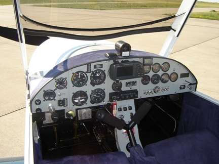

I us a garmin 295 and we have here in Germany a very nice guy who modifiys the map and includes all reporting points, microlight and sailplane airstrips also all the circus for the airfield for only about 50 euro. he can do this on all garmins runs absolut trouble free. see in the attachment my 601 with the 295 installed. you can get nice 2nd hand 295 for about 600 euro so thats good value for money.

PostPosted: Tue Jan 23, 2007 9:48 am    Post subject: Re: Handheld GPS? Reply with quote
What I can tell you is this, If you simply want a large bright color screen display of GPS moving map and course data with an easily accessed airport database, the Lowrance is a much better deal. I have been told it can be linked to a wing leveler or autopliot to steer the course for you enroute on a X-C but I have not actually seen that or done that. In the USA the Jeppeson database for Lowrance includes terrain elevation data which can be clearly displayed on the the lower segment of a split screen.
the garmin 296 or abouve 396/496 will do the same.
for my next xl coming in may i have the 295 linked to the true trak AP so it can steer to the route on GPS but this could be also done with a lowrance.
surtenly if you buy a 600c in the US is is very good value for money
i just find the shape size a bit difficult to fit to the panel.
i just wanted to point out in my earlier mail that there is a possibility to modify the garmin hand held gps here in europe to include some more infos such as airfield circus, obsticals such as windmills (we have far to many of these here) compulsery reporting points etc.
