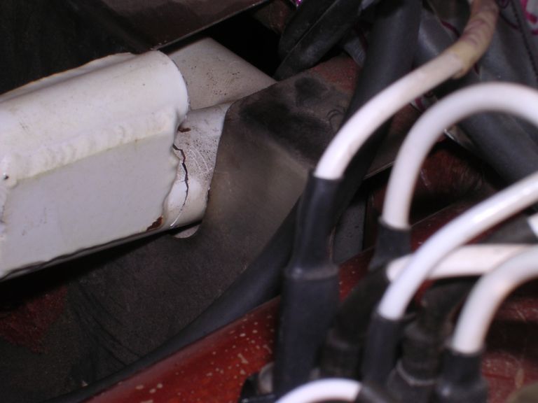

about this Mod, but a look at the attached photo of the first, but not only,
failure should prove interesting.

Note the 'spanner' scratch that appears to have initiated the crack on the
s'bd-side arm.
Glad that EA4 are now awake!

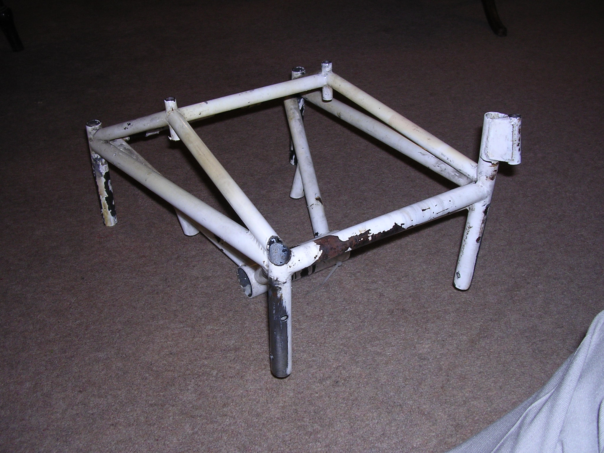

This was with a 914 swinging a 10 pound Whirlwind C.S.  prop.I think that the .050 wall tube was a little light.

This is now two photo’s of failed items I’ve seen which, IMHO I have to agree 100% with you every indication of fatigue is there. My training is likely “old Hat” particularly considering modern alloy extruded tube but I wonder what traceability exists of annealing/stress relieving :-
a) done to these and all frames ? (do certificates exist and where?)
b) what such heat treatment is actually called up on the metals and complex joints in question?
c) what investigation has been undertaken with Rockwell Hardness tests over the whole of the failed frames and in particular close to the failure?
This is all shutting the gate after the horse has bolted but in the total shape of things we need to know along with the question will new ones be produced with up rated tubes and will they have an appropriately designed heat treatment with a certificate?

I doubt that you will get an answer what caused the break. It looks to be that it was most likely a tension break with perhaps some fatigue factor. The upper tubes will have tension in the upper parts and that will be increased by the thrust. There also could be some problem with non annealed brittleness from the closeness of the weld.
The lower tubes should be ok as they have tension stress from weight bearing but that is cancelled by compression.
But then what do I know. My engineering studies were 50 years ago! Now I am just a dumb doc.
Tom

Most likely is excessive vibration, like when you lose a prop blade or
heavy landing/prop strike
Be nice to know though. Wink
Graham
Tom Friedland wrote:
Hi Graham
Tom

O.K. Bob, you woke me up!
Rob Housman's answer is on the ball. Using Redux would necessitate
increasing the clearance between the original tube and the new inserts. The
Redux would not be strong enough to withstand the bending load, which is the
critical part of the overall stress. The insert is intended to be a close
but not interference fit in the outer tubes after reaming. Any small
clearance which may exist after fitting the new tubes will be taken up by
deflection caused by the initial load applied by the weight of the engine
and propeller.
The bending load is applied both by the vertical load from the weight of the
engine acting some 2.5" approx forward of the weld affected area, and also
by the small tube which is about 1" above the main horizontal tube. The
forward thrust from the propeller creates this bending load. To that has to
be added on one side the torque reaction. (Distances are from memory as I am
writing this fom home).
I have made a small change to the Mod leaflet to make the applicability
criteria a little clearer. The factors which affect applicability are
engine and propeller weights and c's of g forward of the undercarriage
mounting frame, and the engine torque.
Briefly all Rotax engined Europas, except those with classic engine
installations and light propellers as defined in the Mod leaflet, will need
to incorporate the Mod. So all Rotax engined XS models, regardless of
whether 912, 912S or 914, and regardless of propeller will need the Mod.
Europas with engines other than Rotax will need to be checked on a case by
case basis. We have already established that Europas with the Jabiru 3300
engine will need the Mod.
It was orginally intended that the news of the Mod would be promulgated by
the PFA and EA4 on their respective websites simultaneously - unfortunately
that did not happen. The PFA have now updated their Type Acceptance Data
Sheet to include Mod 72.
We realise that quite a long time has elapsed since the failure took place
that gave rise to this Mod. It was necessary first to establish that the
failure was not a one-off due to a unique set of circumstances; research
into the original calculations established that there was a more general
problem. The we had to devise a satisfactory solution that would be
reasonably straightforward to incorporate, then carry out tests to prove the
fix. Then the method had to be agreed with the PFA, and the Mod leaflet
written. This latter exercise proved rather drawn out, and several drafts
were needed before the current version was agreed. Establishing why the
original error in stressing was made during the reign of EMIL proved almost
impossible, as the engineer concerned died a few years ago.
I realise that many people may feel that an unnecessary fuss is being made
