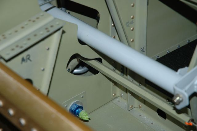

OK, I have finally been through this point and, as promised, am going to provide a little feedback on the jigs that Van’s has us make to rig the controls.
First of all, with the aft-most pushrod for the elevator, getting the elevator rigged correctly (91.4 degrees on the bellcrank by the battery) required me to shorten the pushrod 6 or 7 full threads from the measurement in the plans. This got the elevators in trail and the bellcrank at the angle required.
Second, with both of the forward elevator pushrods, having made them the length called out, I only had to lengthen one of them one full thread to get the elevator in trail using the little measuring bar from the spar forward to the welded control arm in the front. With this rigged, the only place that touched with full elevator travel was the cross-control-bar on the front of the hole in the F-1048L&R as seen in the attached picture. A little grinding on that an we are good to go.
For those of you who are working on this, please don’t forget to put the front bearing of the front pushrod on the end of the rod that was drilled for the safety wire. It is a pain in the neck getting that fixed after everything is installed. Ask me how I know.
So, in summary, I guess not all planes are the same, but I am very glad that the little rigging parts are designed for us. They certainly do work (for me).

Thanks Jesse for the post. I'll probably spend the weekend checking
lengths and angles again!
the controls.
to go.
do work (for me).
