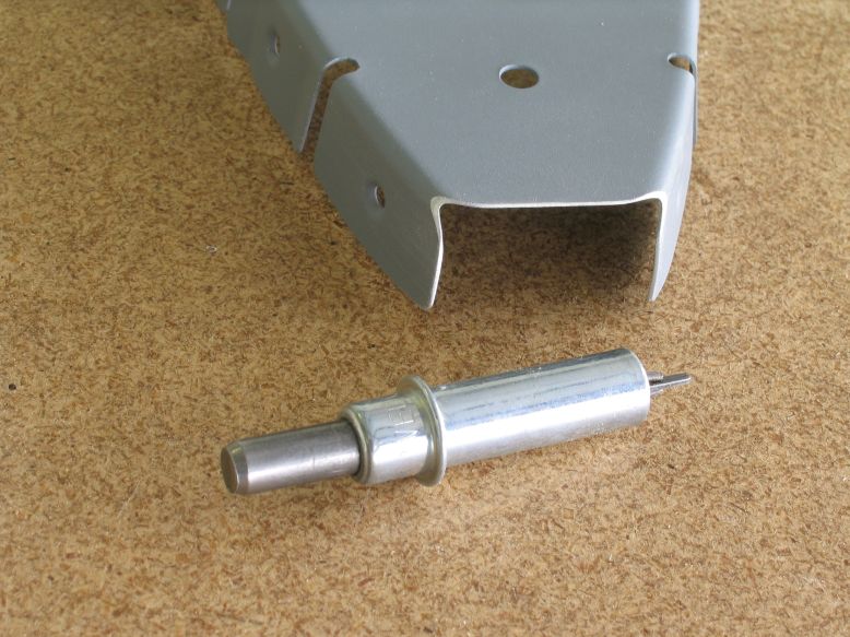

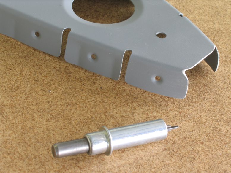

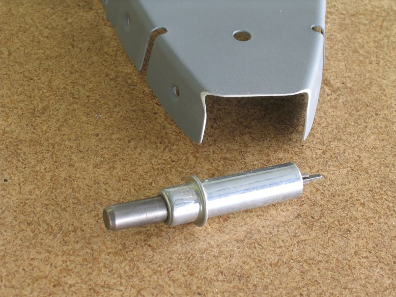

PostPosted: Fri Feb 03, 2006 8:06 am    Post subject: Verticle Stabilizer Reply with quote
Paul,
So the new plans have that as part of the VS?  Great.  As to how much, 1/8 inch is about right.  I've attached a picture or two of what I did.  You might also put a flute in the web at the tip, thereby sucking in the sides a bit to better match the shape of the skins.  It's supposed to be tight, but also it's supposed to not be too tight that you end up deforming the leading edge.
Given that you've taken off enough so the ribs do not sit flush, and does this mean you have a gap, then you might want some new ribs.  You don't want an appreciable gap between the nose of the rib and the leading edge.  If it's noticeable, when you try to rivet, you'll push in the skin at that point.  Some other builders might suggest filling that gap with an appropriate thickness of scrape, and that might work, but ribs are cheap.  I'd start again.
John Jessen
  ~328 (Tailcone)
