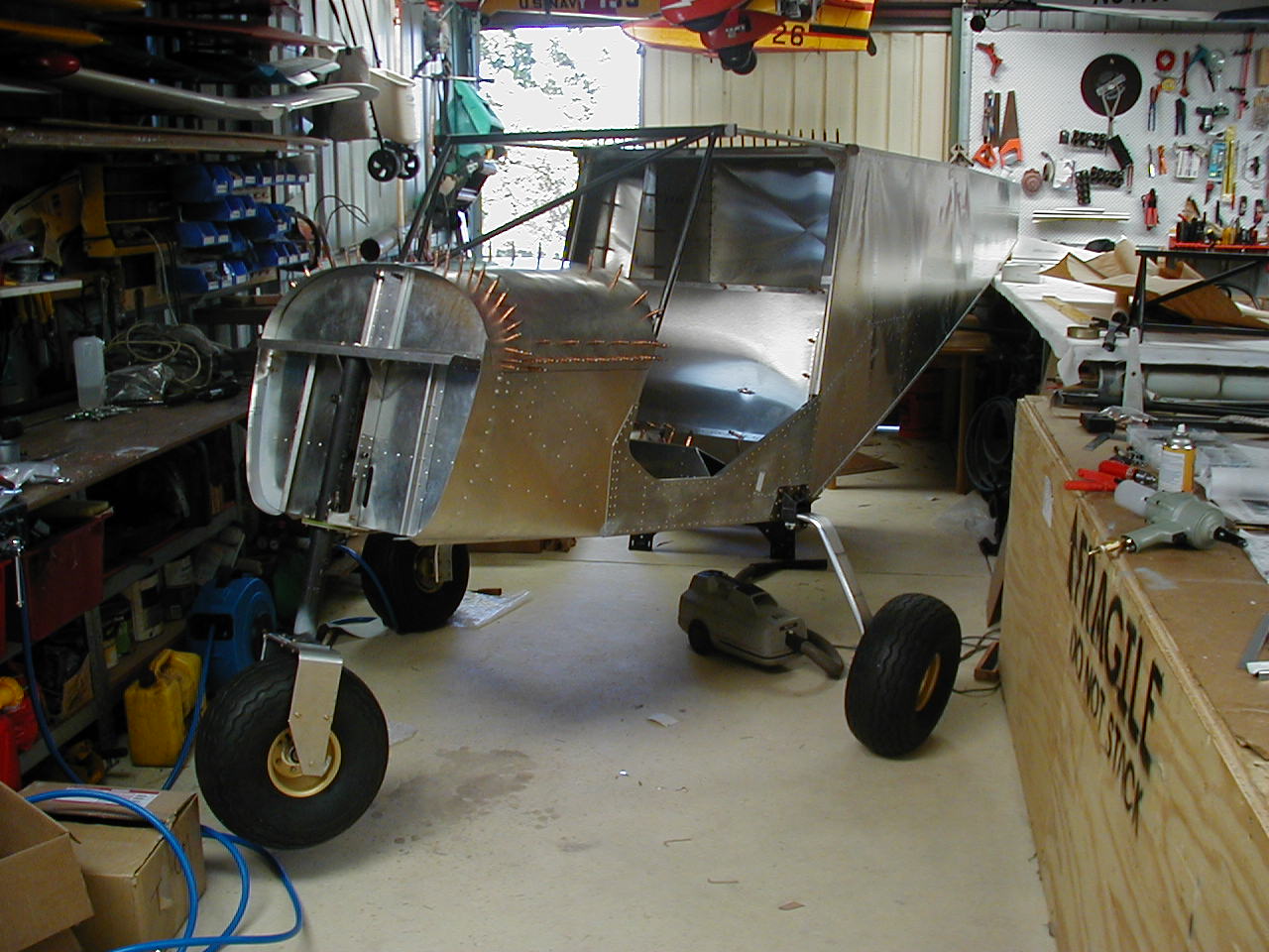

Lol ! Bill...Not that it's in any way important, but in the time you have been pre-polishing I have built the Fuse and the rudder for my 701 (89 hours total...kit arrived on 24th Dec 2006)
 Filesize:  192.01 KB
 Viewed:  564 Time(s)
