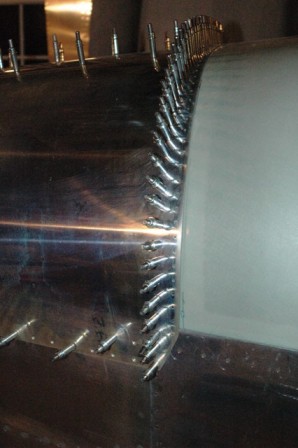

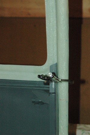

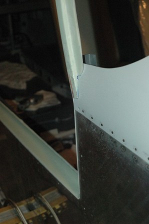

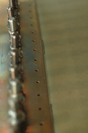

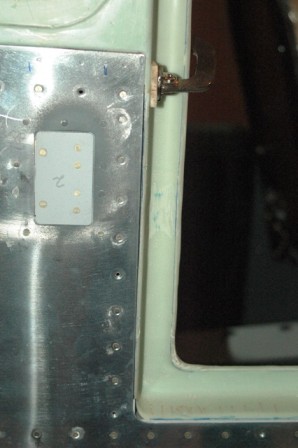

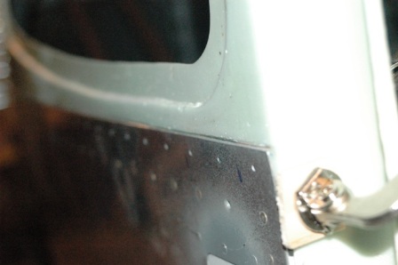

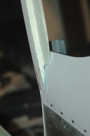

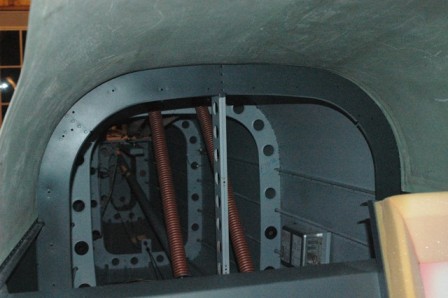

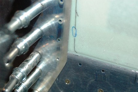

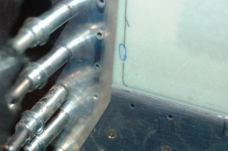

For those interested I have attached some Cabin Cover fit pictures.
Niko

As one can see from the pictures I am well into making Vans cowl fit and I am not planning on a graphite cover. I have about 30 hrs into sanding and fitting it and there are many hours left before its done although given the build times that some people have quoted I consider myself a slow builder. What makes it inconvenient for me is that two people are needed to fit the Cover. So I can't just sand a bit and then fit it take it off resand refit etc. Each time I try to fit it I need a helper. I have probably trial fit it about 8 to 10 times now.  By the way, as a data point on the high end I have 2100 hrs into this kit now and I believe it will take somewhere in the 3000 to 3500 hrs to complete.
The difficult part about making a graphite one would be making the tool. I haven't looked at getting graphite at all but most aircraft manufacturers purchase the high end of the graphite fibers with the medium and low strength ones being sold for things such as skiis, tennis racquets, golf clubs etc. I believe the fiber that doesn't meet the specs of the airframe manufacturers is sold as lower grade. The supply for the high end fibers might be tight and at the same time the supply of the medium to low end fiber might be plentifull. Don't really know though maybe someone else can chime in here.
Niko

Good comments. I have a question related to this discussion, how
"conforming" is the Van's design to the crashworthiness requirements
of FAR part 23 as they relate to roll-overs in a crash? Looking at
these pictures, I really wonder how well the cabin top will hold up in
a roll over. Carbon-epoxy (even the low grade stuff) is tons stronger
and more impact resistant than glass-epoxy matrix. Van's takes pride
in pointing out they design to part 23 requirements and show static
testing of a wing as proof. Note: Part 23 roll over requiremetns after
inverting on the ground are 3.0 g vertical load with a .5 cof of
friction sliding load (23.561) after surviving a 9.0 g longitudinal
crash impact. This means the top (VT contacting ground) has to
withstand 8,100 # of vertical load while also withstanding 4,050# of
sliding interial load in the forward direction. Seems a couple peices
of steel tubing or a few layers of carbon epoxy placed in strategic
positions would greatly enhance crash strength.
Carbon fiber and fiberglass lay-up is essentially the same, both
require a mold. Unless the latest automated carbon fiber layup robots
are used, I don't think you'll see any better quality (where the cabin
top meets the aluminum structure) that you are seeing today with a
hand-layup process regardless whether carbon or fiberglass is used.
Remember, you are fitting an item that has a certain level of process
and dimensional control to items that are made by different processes.
Aluminum forming processes (i.e. drop hammer die, hyrdoforming on form
blocks, or brake forming) is capable of holding tighter profile
tolerances than most hand layup composites. This is why you'll see
mismatches and such between the cabin top and the Al strucutre and
will need to do some hand fitting.

I think I may have started this rough canopy discussion, and I'll go
ahead and say that I just went ahead and made it fit. I got messy. I
put it on there and took it off quite a few times. It fits. I'll make
it smooth, and it'll be neato. It's my first time working with glass,
but metalworking tools make quick work of it. It also makes quick work
of my metalworking tools Smile Initially, I was worried about strength,
but after I got it fitted, it seems that like everything else on the
aircraft, once it's connected to the surrounding structure, it's pretty
tough. I've been having fun pretending that I'm coming in from a
blizzard when I'm done with a cutting session. Covered in "snow". Yay.

PostPosted: Tue Jan 16, 2007 2:20 pm    Post subject: Cabin cover fit pictures Reply with quote
Well I'm well past it and the canopy came out looking great - but could have
done with a little less education on fiberglass work.
