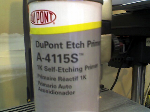

PostPosted: Tue Jan 31, 2006 4:18 pm    Post subject: aerosol primer Reply with quote
I have had very good results with the Dupont self etching primer in an
aerosol can. Also the SEM which is a tad cheaper. They are both available in
green or grey from automotive paint supply shops. See attached pic.

7220 NAPA primer is the same product packaged by SW for NAPA, slightly
different color. Any local NAPA store. Better yet 4115S Dupont self-etching
primer is available from any Dupont Automotive Refinish Store, check the
yellow pages. The advantage to the 4115s is that it is a new product and
actually has some corrosion protection designed in. Some, not much!

PostPosted: Wed Feb 01, 2006 4:15 pm    Post subject: aerosol primer Reply with quote
I would still look for a local source for the Dupont primer in an aerosol form ( see pic in my original post). Good company which has brought out a very competitive product. Body shop and painting folks trust products from Dupont. I have used it and like it so far. Not to belittle SW. My Cessna now, I chose to go with all SW products and have Get glow paint and primers on it when we stripped and completely redid it. So there. But then its ONLY A CESSNA !!! J
