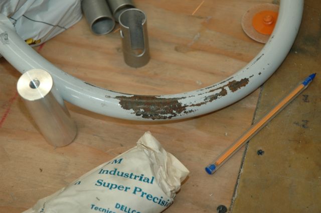

Has anybody else on the list seen this type of quality on the powder-coated parts?

Hi. Looks as if the metal has not been prepared properly, should be dipped to remove grease,cutting fluid etc. Send it back, tell 'em to do it right.............
