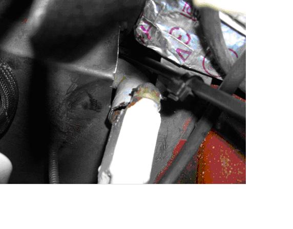

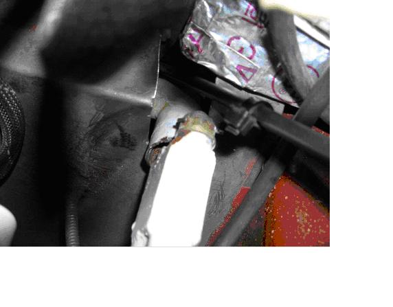

I have to assume that it is if the same type of failure which occurred
about 1 year ago (!), and was actually posted to this list (email
below). Nobody appeared to take notice at the time. I followed up with
an email to Sam requesting a Pic, which I have attached.
I always considered that stress-point at the bracket a weak point, and
am glad that they are addressing it (if it is the same defect!).
Cheers & blue skies,
Peter Zutrauen
Europa Builder A239 dual-wing
http://europa.zutrasoft.com
Ph: 613-831-0348
Cell: 613-850-5551
-----Original EUROPA-LIST Message-----
From: owner-europa-list-server(at)matronics.com
[mailto:owner-europa-list-server(at)matronics.com] On Behalf Of
SPurpura(at)aol.com
Sent: Saturday, January 07, 2006 9:33 PM
Subject: L.G. FRAME CRACK
During preflight today I noticed that the spinner was a little offset
and
hanging a bit low,after removing the cowl I found that the l.g. frame
had cracked
& separated just behind the port upper motor mount. I believe the crack
occured when the manifold cross-over tube was disconnected during carb
balancing
several months ago and the 914 ran so rough (with the cross-over
disconnected )
that it was shut down for fear of breaking a motor mount. If anyone
would
like to see a pic.,let me know where to post it. Sam N77EU
----- FOLLOW UP Message-----
From: SPurpura(at)aol.com [mailto:SPurpura(at)aol.com]
Sent: Sunday, January 08, 2006 8:46 PM
To: Peter Zutrauen
Subject: Re: L.G. FRAME CRACK
The pic shows the tube failed just behind the weld.
I will insert another 4130 tube/rod inside obout 4" long & tig weld the
separated member and the new reinforcment will be welded at the open end
of repaired tube. I will also do this to the starboard side.
 Filesize:  25.95 KB
 Viewed:  671 Time(s)

L.G. FRAME CRACK
noticed that the spinner was a little offset and
hanging a
frame
had cracked
& separated
crack
during carb balancing
so rough (with the cross-over disconnected )
that it was
would
like to

PostPosted: Sat Jan 13, 2007 3:17 pm    Post subject: Mandatory mod no 72 Reply with quote
Which underlines a point that the description given in the E04 text for Mod
72 is off the mark. It tries to be clear about the effected area but, if
this is it, fails.
Would make inspection easier though!
Duncan McF.
