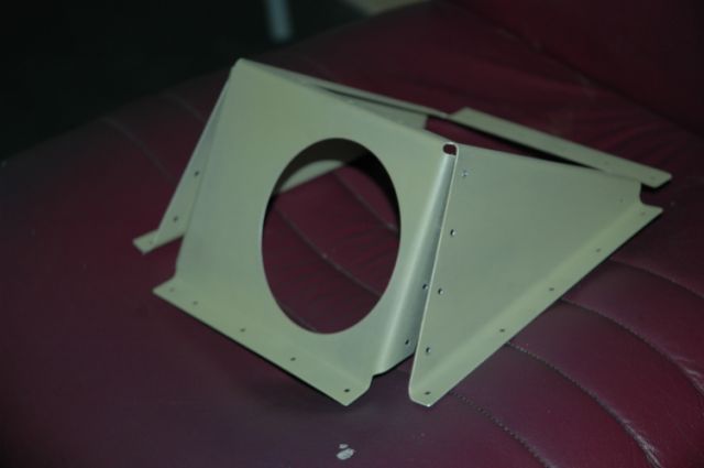

I have a question for those who have received FWF kits recently. In the attached picture you can see the oil cooler bracket that I am working on. Notice anything missing? Van’s sent this to me, but it doesn’t have the flange for the scat tube. Is it possible that they have modified the plans and we are supposed to rivet on a flange like goes on the baffles? In the past it had the flange welded to the bracket.
Anybody else seen this? I am going to call Van’s, but they haven’t opened yet.

Did they at least include the flange? If not, then I'm sure it's just
a defect. If so, perhaps it can be riveted and sealed.

The didn't include anything else. I have an e-mail in to them. Bruce in
tech support said it is probably a manufacturing defect, but "I don't know
much about parts" was his comment.

Jesse, I received mine recently and the scat tube ring is attached and
it's not riveted but welded (tack) to the oil cooler bracket.

Got mine last week. Flange was welded on but it sure was a bear to rivet to the firewall.
