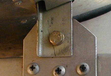

I got to 200 hours befor I found 1-inch cracks through both mounts. Scared the heck out of me Shocked . You'll sleep better after you replace the .040 mounts with the .060 ones.
Rick
Just where were those cracks - can you see them without disassembly??

Hi JG,
Here is a photo of right forward mount. They were very visable. So checking for cracks is now a part of every pre-flight.
Rick
