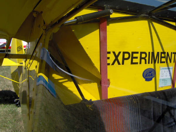

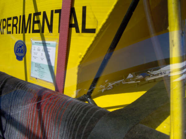

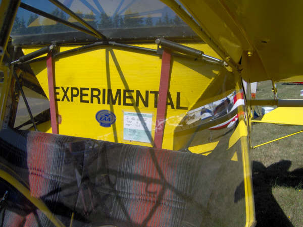

roncarolnikko(at)hotmail.
PostPosted: Fri Dec 29, 2006 5:23 pm    Post subject: wing tank model 2-3 Reply with quote
The weights and balance might be a challenge, but I saw a rear mounted tank
at Arlington this year. I'll try to attach a picture or three. Ron NB Ore

Ron, Thanks for those pics of the rear tank.
Looks like a fair size.
I have a dash tank and 2 6 gal tanks in wings. When on floats I am
restricted to about 3.5 hours and a bit.
I can take gas in floats but an extra 5 to 10 gals behind seat would extend
me 1 to 2 hours . So i can fly in 3 hours and still have enough for return
without refueling.
Dave
